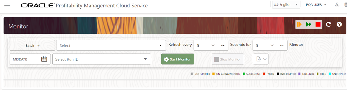

  1. Click Monitor Batch from the Header panel.
    The Monitor Batch Page is displayed.
    Figure 18-7 Execution Schedule Page
  2. Select the Batch/Batch Group from the Select drop-down and then select the Batch Run ID from the Run ID drop-down.
  3. Click Start Monitor.
    The results are displayed in Visualization and List View tabs. Details of these tabs are as follows:
