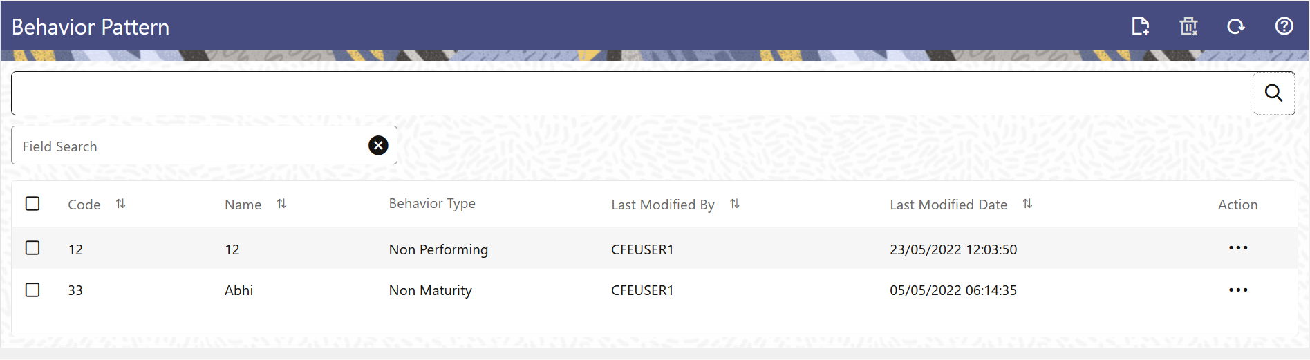

To open the Behavior Pattern Summary Window and search the Behavior Patterns, perform the following steps:
- From the LHS menu, select Maintenance, and then select
Behavior Pattern to open the Behavior Pattern Summary Page. This page is
the gateway to all Behavior Patterns and related functionality. You can navigate to
other pages relating to Behavior Patterns from this page.
Figure 16-1 Behavior Pattern Summary Page
The Summary Page of Behavior Pattern displays the Search Criteria Pane, Field Search (Specific Search) Pane, and the already created Behavior Patterns and their details.

The search results are displayed in a table containing all the Behavior Patterns that meet the search criteria with the following details:
- Code: The code of the Behavior Pattern.
- Name: The name of the Behavior Pattern.
- Behavior Type: The type of the Behavior Pattern.
- Last Modified By: Displays the Name of the user who last modified the Behavior Pattern.
- Last Modified Date: Displays the Date and Time at which a Behavior Pattern was last modified.
