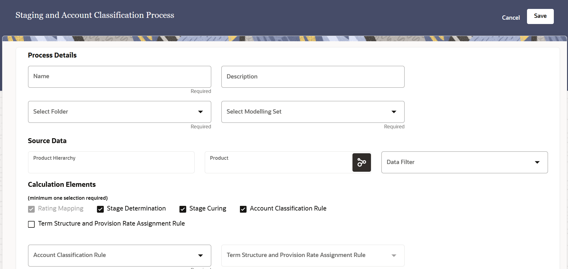

Create a Staging and Account Classification Process
Perform the following steps to create a Staging and Account Classification Process definition:
- On the Staging and Account Classification Process Summary page, click
the Add icon to open the Staging and Account
Classification Process window.
- Populate the Staging and Account Classification Process Form as
tabulated:
Option Description Name Enter a name for the Staging and Account Classification Process definition. This is a mandatory field.
Description Enter a description for the Staging and Account Classification Process definition. Select Folder Select a folder from a drop-down list. This is a mandatory field.
Select Modelling Set Select a folder from a drop-down list. This is a mandatory field.
Product Hierarchy When a folder is selected from the Modelling Set field, this field is automatically populated. Data Filter This field allows you to select a subset of data for processing by selecting a filter that was previously created. Select a data filter from the drop-down list. Note:
This service supports only the Data Element FiltersCalculation Elements This section contains the different Calculation Elements. The available options are: - Rating Mapping - This check box is uneditable. If the Stage Determination is selected, then by default the Rating Mapping will be selected.
- Stage Determination - If this Calculation Element is selected, then the Stage Determination Rules field is enabled in the below list .
- Stage Curing - If this Calculation Element is selected, then the Stage Curing Rules field is enabled and Stage Determination calculation element is also enabled based on Stage Curing selection.
- Account Classification Rule - If this checkbox is selected, then the Account Classification Rule field is enabled.
- Term Structure and Provision Rate Assignment Rule- If this checkbox is selected, then the Term Structure and Provision Rate Assignment Rule field is enabled.
It is mandatory to have at least one calculation element selection.
Account Classification Rule Select an account classification rule from the drop-down list. This field is only enabled if the Account Classification Rule check box is selected. This is a mandatory field if the Account Classification Rule check box is selected.
Term Structure and Provision Rate Assignment Rule Select a Term Structure and Provision Rate Assignment rule from the drop-down list. This field is only enabled if the Term Structure and Provision Rate Assignment Rule check box is selected. This is a mandatory field if the Term Structure and Provision Rate Assignment Rule check box is selected.
