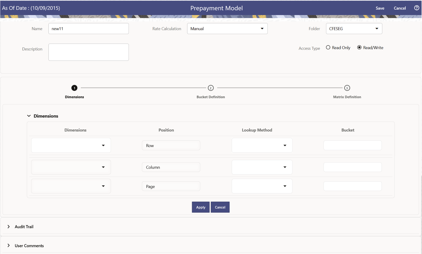

Creating Prepayment Model with Rate Calculation as Manual
To create a Prepayment Model Rule, follow these steps:
  1. Navigate to the Prepayment Model Summary Page.
  2. Click Add. The Prepayment Model Details Page is displayed.
    Figure 4-58 Prepayment Model
    Prepayment Model
  3. Enter the following details:
    • Name: Enter the name and a brief description for the Prepayment Model. The name you assign to the Prepayment Model must be unique. The name can hold a maximum of 30 characters.
    • Rate Calculation: Select the Prepayment Model Rate Calculation Method as Manual. Using Manual Method, you can select maximum of three Prepayment Dimension and assign prepayment rates manually to selected dimension.
    • Folder: Select the Folder
    • Description: Enter the description of Prepayment Model Rule.
    • Select Access Type.
  4. Follow below steps:
    Defining the Structure of the Prepayment Model Using Dimensions section
    Modifying the Table Structure Using Bucket Definition section
    Prepayment Rates Using Matrix Definition
