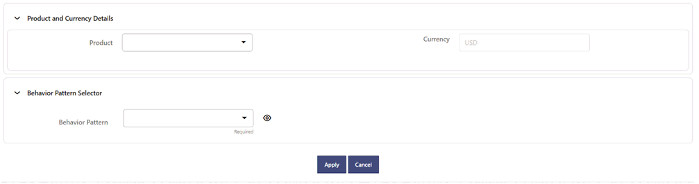

- Navigate to the Behavior Pattern Rule Assumption Details Page after selecting a
Currency and one or more products from the hierarchy.
Figure 4-97 Behavior Pattern Rule Assumption Details
- Select a Product.
- Select the Behavior Pattern from Behavior Pattern drop-down list. Here, the Behavior
Pattern drop-down list shows the list of existing Behavior Patterns.
Click below icon to view the details of selected Behavior Pattern.
Figure 4-98 View Behavior Pattern
You can select only one Behavior Pattern at a time.
- Click Apply.
The Assumption Browser Definition Page is displayed.
