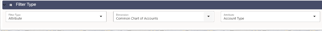

When you have selected the Filter Type as Attribute, define the Filter conditions by doing the following in the Attribute Selection Section:
Figure 4-27 Attribute Filter Type Selection
  1. Select the required Dimension from the drop-down list.
  2. Select the associated Attribute from the drop-down list.
    The list consists of only Dimension Type attributes for selection.
    The Attribute Values pane displayed.
  3. Click Search (search_icon). The list of attribute values associated with the selected Attribute are displayed.
  4. Click the Action (action_icon) button adjacent to the attribute to be added and click Copy.
  5. The Attribute value is added the Attribute Values pane.
  6. Click Add button in the Attribute Values pane. The Filter Conditions grid is populated with the filter condition using all the Attribute values.
