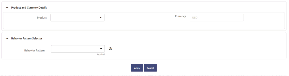

  1. Navigate to the Behavior Pattern Rule Assumption Details Page after selecting a Currency and one or more products from the hierarchy.
    Figure 4-99 Behavior Pattern Rule Assumption Details
  2. Select a Product.
  3. Select the Behavior Pattern from Behavior Pattern drop-down list. Here, the Behavior Pattern drop-down list shows the list of existing Behavior Patterns.
    Click below icon to view the details of selected Behavior Pattern.
    Figure 4-100 View Behavior Pattern
    You can select only one Behavior Pattern at a time.
  4. Click Apply.
    The Assumption Browser Definition Page is displayed.
    At this point you can:
    • Continue selecting BP for other product-currency combinations by repeating the above procedure.
    • Complete the process by clicking Save.
When you click Save, the Behavior Pattern Rule assumptions are saved and the Behavior Pattern Rule Summary Page is displayed.
