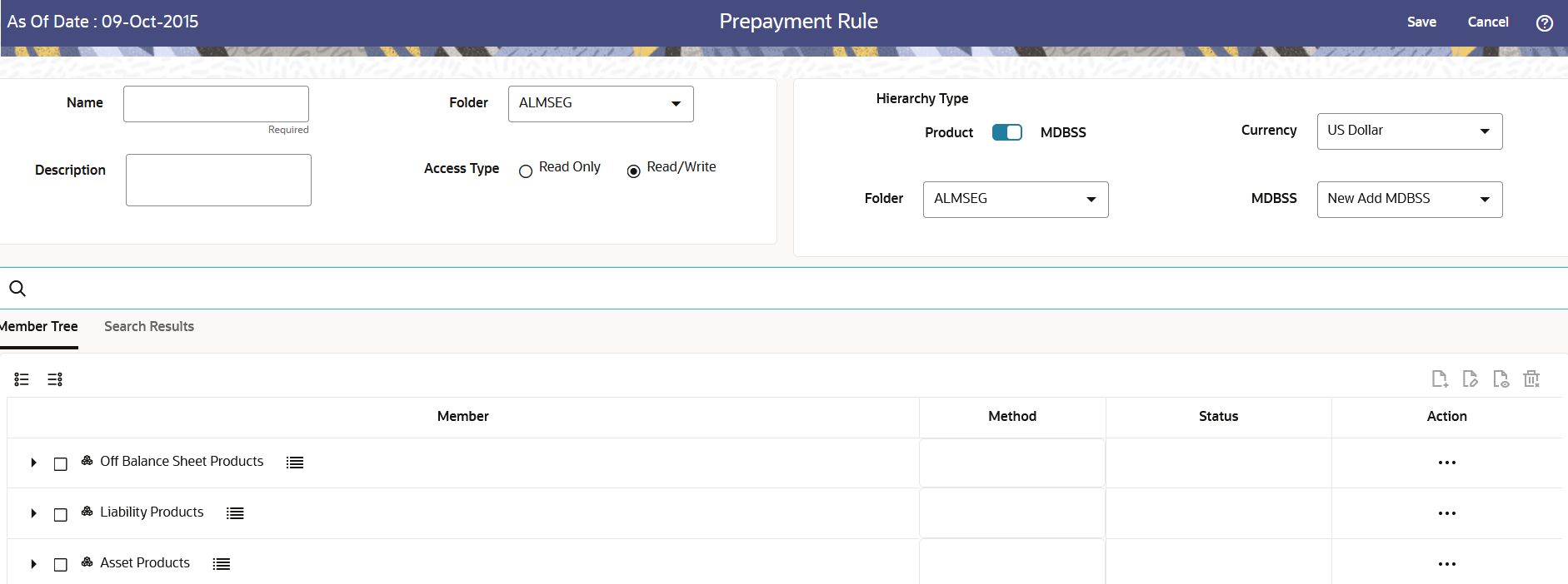

    • If you select Hierarchy Type as MDBSS, then following options are available:
      Figure 4-72 Hierarchy Type as MDBSS
      1. Select a Currency.
      2. Select a MDBSS Folder and MDBSS.
      3. Select MDBSS Node(s) from Member Tree of Assumption Browser. The Assumption Browser has following two tabs: Member Tree and Search Results

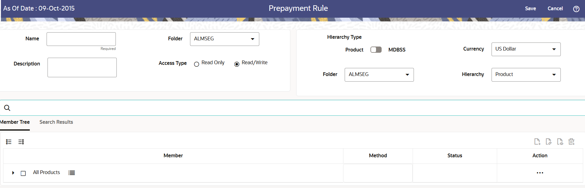

    • If you select Hierarchy Type as Product, then following options are available:
      Figure 4-76 Hierarchy Type as Product
      2. Select a Product Folder and Product Hierarchy.
      3. Select Product from Member Tree of Assumption Browser. The Assumption Browser has following two tabs: Member Tree and Search Results
