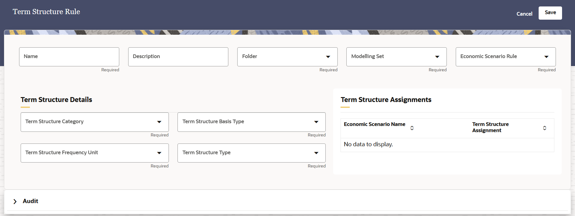

Create a Term Structure Rule
Perform the following steps to create a Stage Determination Rule:
  1. On the Term Structure Rules Summary page, click the Add icon to open the Term Structure Rulewindow.
  2. Populate the Term Structure Rules form as tabulated:
    Figure 4-117 Create a Term Structure Rule
    Table 4-53 Term Structure Rule
