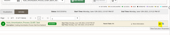

Perform the following steps to view the execution parameters:
- Navigate to Operations and Processes, select Scheduler, and then select Monitor Batch.
- Select Batch and Run Id.
- Click Start Monitor.
- Click List View Tab.
- Click View Execution Logs icon to view Batch
Logs.
Figure 5-12 View Execution Parameter
