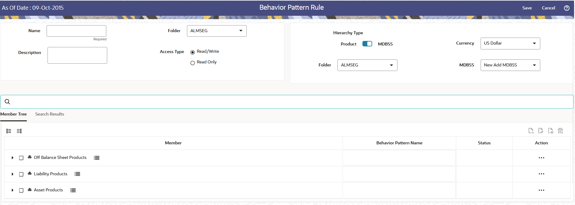

- If you select Hierarchy Type as MDBSS,
then following options are available:
Figure 4-94 Hierarchy Type as MDBSS
- Select a Currency.
- Select a MDBSS Folder and MDBSS.
- SelectMDBSS Node(s) from Member Tree of

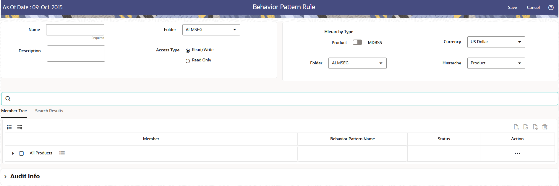

- If you select Hierarchy Type as Product,
Figure 4-98 Hierarchy Type as Product
- Select a Product Folder and Product Hierarchy.
- Select Product from Member Tree of Assumption
Browser. The Assumption Browser has following two tabs: Member Tree
and Search Results
- Member Tree: Member Tree
tab shows the hierarchical structure and allows you to
define rules by selecting the node members from the browser.
Select Node and Click Menu icon next to it to view the
available options.
Figure 4-99 Member Tree
Status of node is also displayed in Member Tree section, for example Selected, and so on. To select member hierarchy, following options are available:
- Expand self, child and descendants: Allows to expand the selected node itself along with its child and descendants.
- Expand selected member/branch: Allows to expand the selected node
- Select UnSelect self, child: Allows to unselect the selected node itself along with its child
- Select UnSelect self, child and descendants: Allows to unselect the selected node itself along with its child and descendants.
- Select Defined self, child: Allows to select the selected node itself along with its child.
- Select Defined self, child and descendants: Allows to select the selected node itself along with its child and descendants.
- UnSelect self, child and descendants: Allows to unselect the selected node itself along with its child and descendants.
Use Show Numeric Code Values (Left) icon to view the code value left to the Node name.
Use Show Numeric Code Values (Right) icon to view the code value right to the Node name.
Here, you can perform the following tasks on the selected node(s):
- Add
- Edit
- View
- Delete
- Copy
