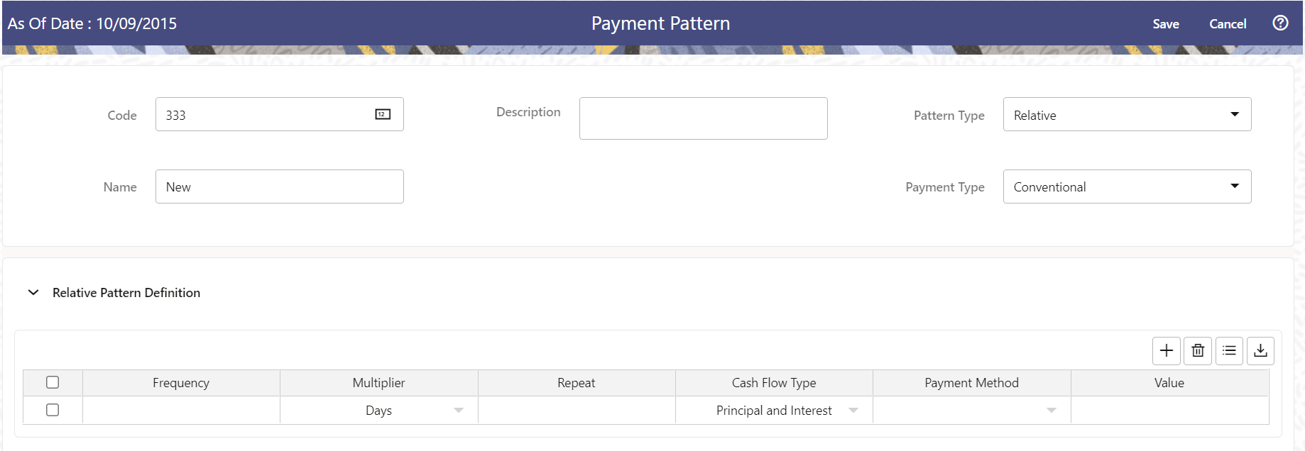

Selecting Relative as the pattern type.
Figure 4-90 Relative Payment Patterns
To define a relative payment pattern, follow these steps:
- In the Payment Patterns page, select Pattern Type as Relative.
- Select the Payment Type from the drop-down list: Conventional, Level

The payment type determines the available characteristics for defining the payment amount.
- Define the Payment Phase.
The payment type determines the type of information required to successfully define the payment phase. For more details, see: Relation between Payment Phase Attributes and Payment Types.
- Enter the Frequency for each payment phase.
