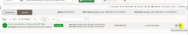

Viewing Logs
You can view the information about high-level processing steps from User
Interface. To view the OFSASBCS Process information, follow these steps:
- Navigate to Operations and Processes, select Scheduler, and then select Monitor Batch.
- Select Batch and Run Id.
- Click Start Monitor.
- Click List View tab
- Click View Execution Logs icon to view
Batch Logs.
Figure 5-12 View the Process Information
