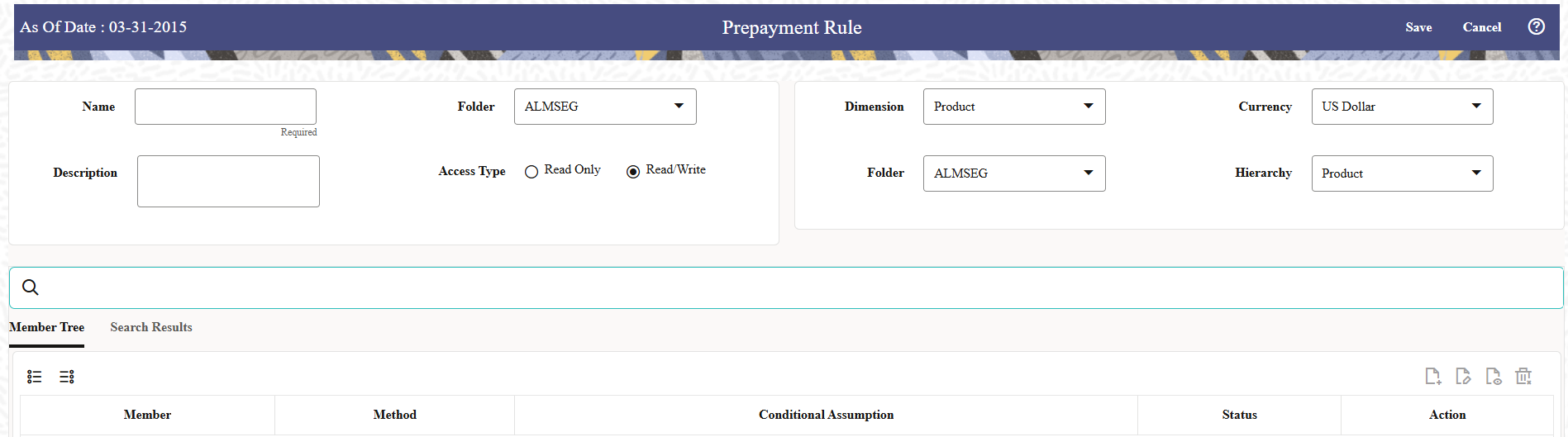

To create a new Prepayment Rule, follow these steps:
- Click Add icon from the top of the Prepayment Rule Summary
page.
Figure 4-76 Prepayment Rule
- Enter the following Details.
- Name: Enter the name of the Prepayment Rule.
- Description (optional): Enter the description of the Prepayment Rule.
- Folder: Select the Folder where the Prepayment Rule needs to be saved.
- Access Type: Select the Access Type as Read-Only or Read/Write.
- Select the Dimension as Common Chart of Accounts, Product,
General Ledger Account, or MDBSS.
MDBSS is enabled only in ALM Cloud Service.If any member is a currency in the MDBSS hierarchy (for example, INR) and selected currency is different (for example USD), then the member and its children nodes cannot be defined.
You can search the rule on any of the product dimension, searched dimension will be auto-populated while defining the rule; if you like, you can change the default product dimension.
- Select a Currency.
- Select Folder and Hierarchy.
- Select Member Node(s) from Member Tree of Assumption Browser.
