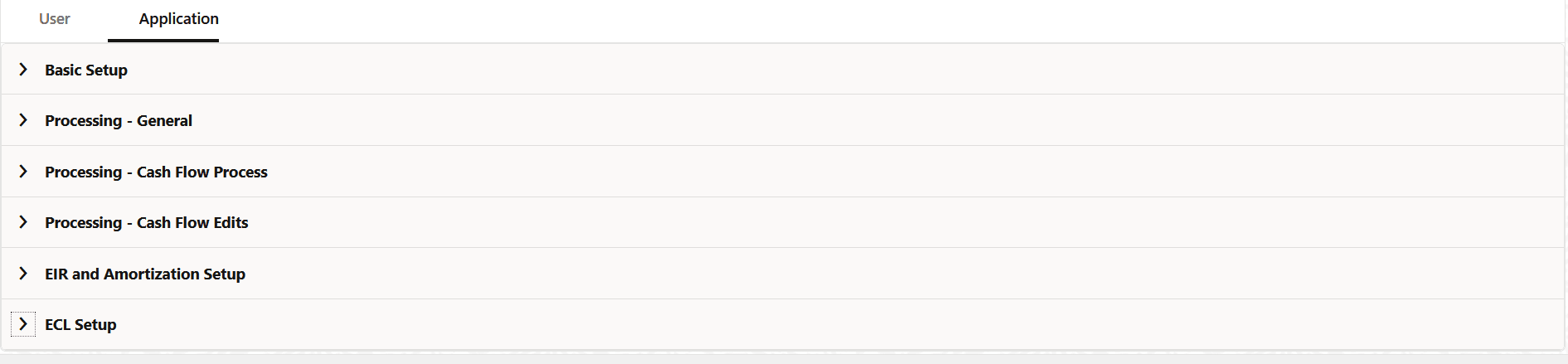

Application Preference
The Application Preferences UI allows administrators and end users to establish default values, manage other core application parameters that affect the way business rules are created and the way processes are run.
To update the application preferences, perform the following steps:
  1. Navigate to Maintenance and select Preferences.
  2. Click the Application tab.
    Figure 4-23 Application Preferences

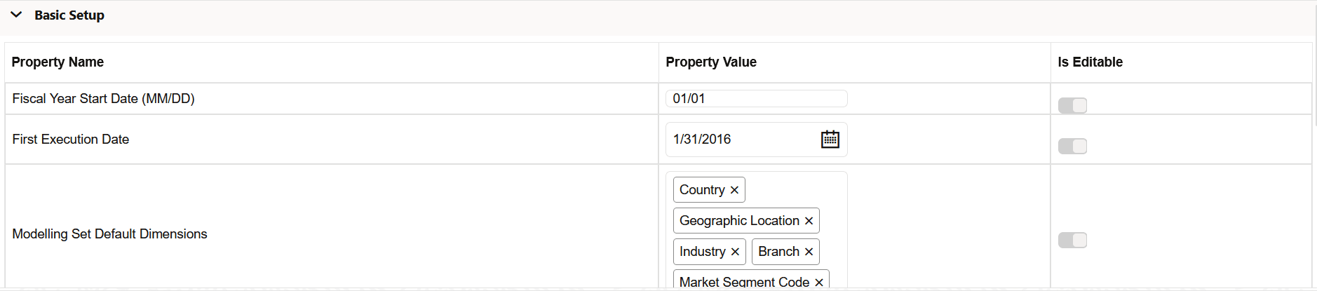

  3. Populate the Basic Setup form as tabulated:
    Figure 4-24 Basic Setup
    Basic Setup
    Table 4-17 Basic Setup
    Fields Description
    Fiscal Year Start Date (MM/DD)
    The start date of the Fiscal Year.
    First Execution Date
    The first date of the execution.
    Modelling Set Default Dimensions The default dimensions present in the application. The default dimensions are:
    • Country
    • Geographic Location
    • Industry
    • Branch
    • Market Segment Code
    The user can select the other required dimensions from the drop-down list or select CTRL + F to search the required dimensions.
    FICO Score Source The FICO Score Source. Select either ALL or NA from the drop-down list.

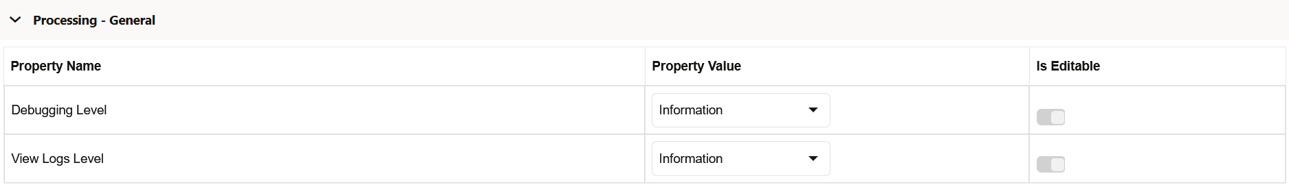

  4. Populate the Processing - General form as tabulated:
    Figure 4-25 Processing - General
    Table 4-18 Processing - General
    Fields Description
    Debugging Level
    The debugging output level determines the amount of SQL that will be written to the processing log. There are eight available levels:
    1. Trace: Designates finer-grained informational events than the DEBUG.
    2. All: All levels including custom levels.
    3. Error: Designates error events that might still allow the application to continue running.
    4. Information: Designates informational messages that highlight the progress of the application at coarse-grained level.
    5. Debug: Designates fine-grained informational events that are most useful to debug an application.
    6. Fatal: Designates very severe error events that will presumably lead the application to abort.
    7. Warning: Designates informational messages that highlight the progress of the application at coarse-grained level.
    8. Off: The highest possible rank and is intended to turn off logging.
    Note: A log request of level p in a logger with level q is enabled if p >= q. This rule is at the heart of log4j. It assumes that levels are ordered. For the standard levels, we have ALL < DEBUG < INFO < WARN < ERROR < FATAL < OFF.
    View Logs Level
    This displays the severity of the information by informing you about how important a given log message is. This shows the view level of the log. There are three available levels:
    1. Information: Designates informational messages that highlight the progress of the application at a coarse-grained level.
    2. Debug: Designates fine-grained informational events that are useful to debug an application.
    3. Off: The highest possible rank and is intended to turn off logging.

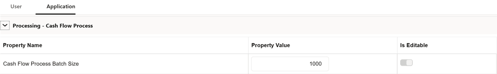

  5. Populate the Processing - Cash Flow Process form as tabulated.
    Figure 4-26 Processing - Cash Flow Process
    Table 4-19 Processing - Cash Flow Process
    Fields Description
    Cash Flow Process Batch Size
    The number of account or instruments that must be processed in a single batch. This is used by the cash flow engine for performance tuning.
    A default value of 1000 is seeded by the service and you can modify it as needed

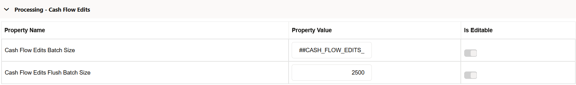

  6. Populate the Processing - Cash Flow Edits form as tabulated.
    Figure 4-27 Processing - Cash Flow Edits
    Table 4-20 Processing - Cash Flow Edits
    Fields Description
    Cash Flow Edits Batch Size Number of Account or Instruments that must be processed in a single batch. This is used by Cash Flow Edits Engine for performance tuning.
    Default Value of 1000 is seeded by the service, and you can modify it as needed
    Cash Flow Edits Flush Batch Size Number of records that gets saved or updated in a batch during Cash Flow Process execution. This is used by Cash Flow Engine for performance tuning.
    Default Value of 500 is seeded by the service, and you can modify it as needed

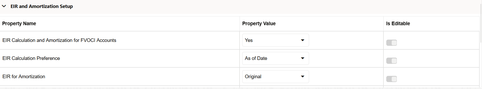

  7. Populate the EIR and Amortization Setup form as tabulated.
    Figure 4-28 EIR and Amortization Setup
    Table 4-21 EIR and Amortization Setup
    Fields Description
    EIR Calculation and Amortization for FVOCI Accounts If this feature is selected, then the FVOCI accounts are included in the scope of the EIR calculation and amortization.
    Select either Yes or No.
    EIR Calculation Preference For the EIR calculation, the number of days is determined based on the difference between the contractual cash flow date and the date selected in this preference.
    Select either As of Date or Last Payment Date.
    EIR for Amortization For amortization purposes, the user can select the EIR that needs to be used.
    Prepayment is considered Modification Event If this feature is set to Yes, then the prepayment is treated as a Modification/Derecognition event.
    NPV Test Select either Not Applicable or Applicable.
    NPV Test Threshold A quantitative (Net Present Value) test that is used to determine whether changes in account contracts result in a derecognition or modification event.
    Enter a value in this field to determine the threshold for the NPV test.
    Separate amortization of Modification Gain/Loss If this feature is enabled, then the Modification Gain/Loss can be amortized separately.
