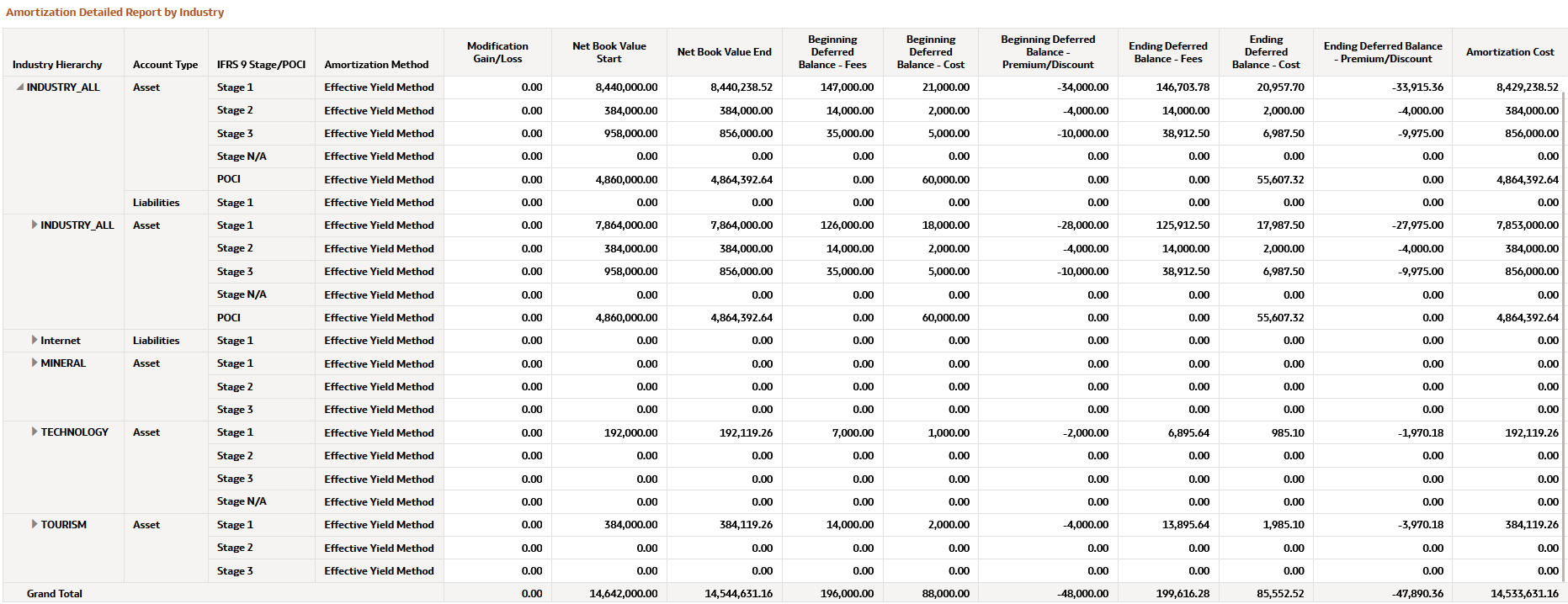

This is the fifth canvas under Amortization Reports. The pinned filters and additional dimension-based filters i.e., Industry Hierarchy, and Industry Leaf are required to generate this report. If Multiple industry hierarchies are present, then it is ideal to select a single industry hierarchy. Industry leaf can be selected based on the selection of industry hierarchy. The industry is a hierarchy-based dimension so this report will provide amortization measures at industry hierarchy levels.
These reports can be viewed as Standalone or Consolidated reports.
To generate the below reports following dimensions are used: As of date, Modelling Set, ECL and Amortization Process, Consolidation Type, Legal Entity Hierarchy Name, Legal Entity Node, and Industry Hierarchy Name, Industry Node and Reporting Currency Name.
Figure 7-77 Amortization Detailed Report by Industry Report
