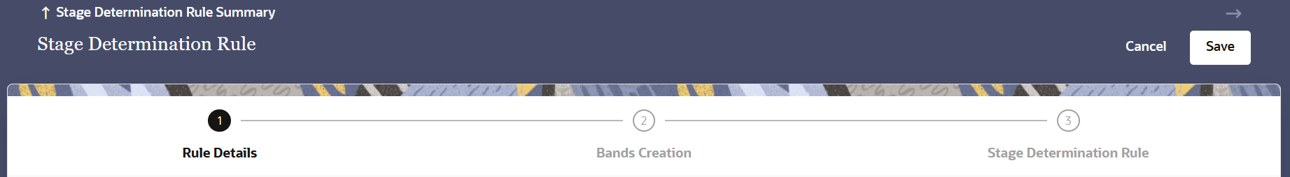

4.4.4.1.1 Create a Stage Determination Rule
Perform the following steps to create a Stage Determination Rule:
- On the Stage Determination Rules Summary page, click the Add icon to open the Stage Determination Rule Window.
- On the Stage Determination Rules window, you must first define the
Rule Details, Bands Creation,
and then the Stage Determination Rules.
- Populate the Stage Determination Rule - Rule Details form as
tabulated:
Option Description Name Enter a name for the Stage Determination Rule definition. This is a mandatory field.
Description Enter a description for the Stage Determination Rule definition. Select Folder Select a folder from the drop-down list. This is a mandatory field.
Select Modelling Set Select a Modelling Set from the drop-down list. This is a mandatory field.

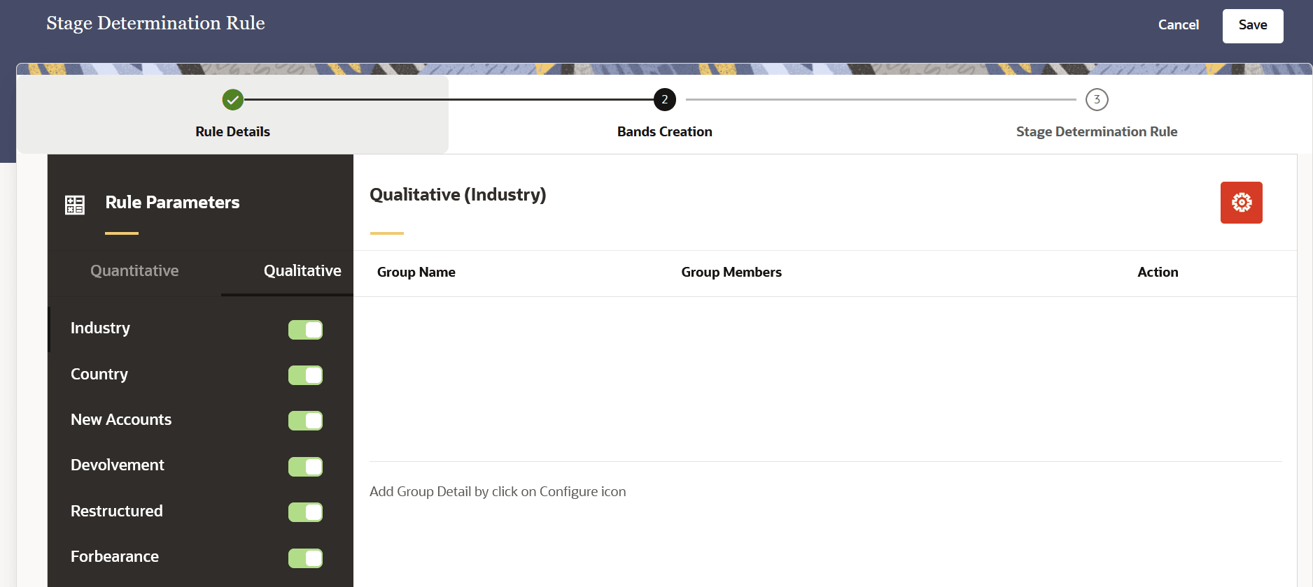

Bands Creation - Rule Parameters (Qualitative)form as tabulated:
- The available options can be enabled or disabled. Additionally, When the Industry or Country options are enabled, the Industry Configuration and Country Configuration buttons are enabled respectively.
- Click the Industry Configuration button to configure the Industry. In the Industry window, in the group name field, enter the name. In the hierarchy browser pane, move the desired groups to the Selected pane, and then click Add Group. The group is added to the pane. Additionally, select the Delete icon to delete a group.
- Click the Country Configuration button to configure the Country. In the Country window, in the group name field, enter the name. In the Country drop-down list, select the desired countries and then click Apply. The group is added to the pane. Additionally, select the Delete icon to delete a group.
- The rules that are enabled in the Bands Creation tab will be available in the Stage Determination Rules tab.

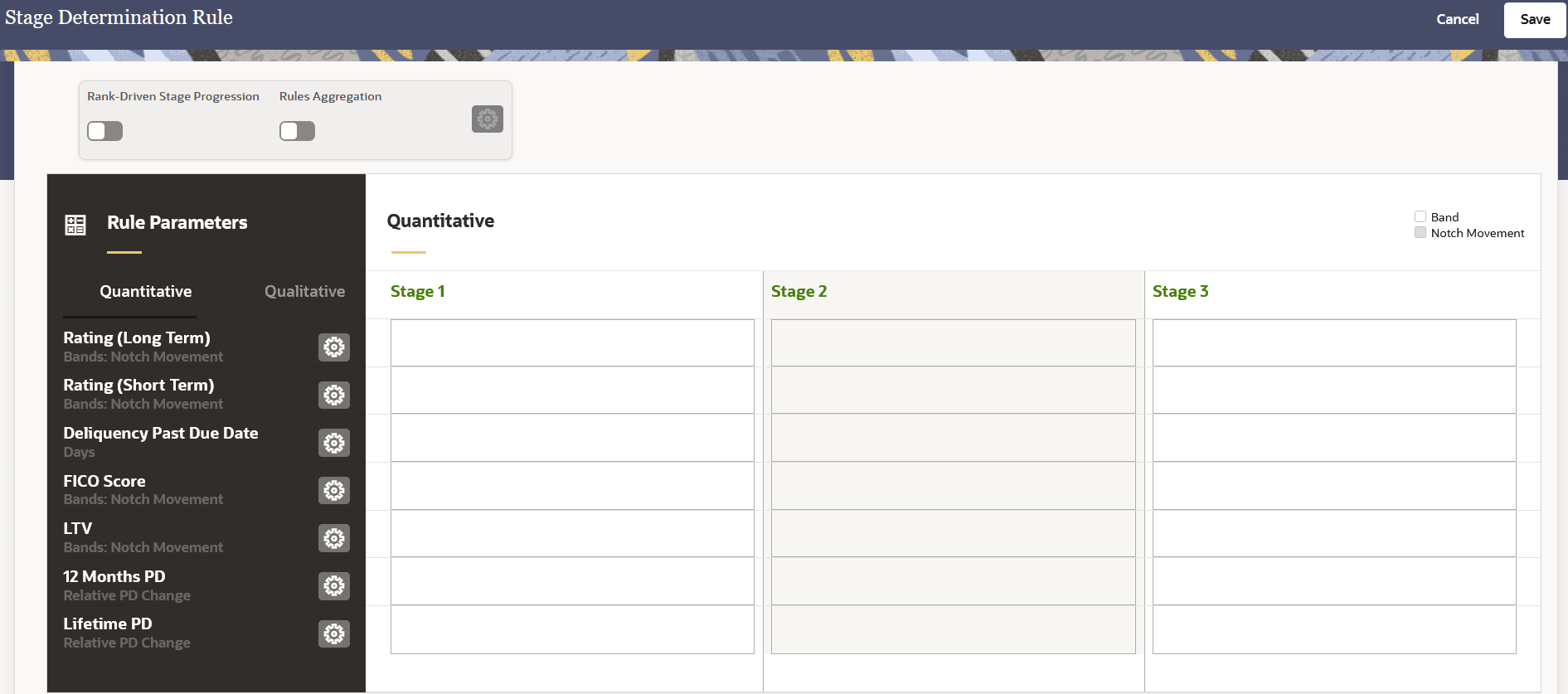

- Populate the Stage Determination Rule - Stage Determination Rules - Rule
Parameters (Quantitative)form as tabulated:
Option Description Rank-Driven Stage Progression Users can define the processing order of rules for stage assignment. For example, if 10 rules are added, the system will execute them in reverse order (from Rule 10 to Rule 1). The stage is assigned based on the most recent rule execution.
Click this slider to enable this feature. When this feature is selected the Rule Integration button is enabled. Click either or both the sliders to add the rule parameters:- Select a rule parameter from the Rule Parameters
drop-down field.
Only a unique parameter can be added in the list. - Additionally, click the delete icon to delete a parameter
- Click Apply.
Rules Aggregation Users can combine multiple rules with an “AND” condition, by ensuring that the appropriate stage is assigned when all specified criteria are met.
drop-down field.
- Click Apply.
