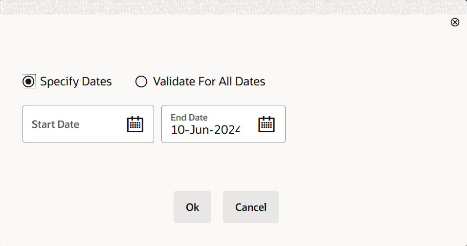

To execute the Exchange Rate Validation, follow these steps:
  1. Click Currency Rates Validation.
    Figure 4-8 Currency Rates Validation
  2. To execute Exchange Rate validation from the Currency Rates window, the following options are available:
    • Specify Dates: After selecting this option, a Select Dates Pane is displayed to enter or verify the Start Date and End parameters. These dates will be passed to the batch for execution.
    • Validate For All Dates: Select this option to validate all the rates irrespective of dates.
    • Start Date: This defaults to the date of last rate validation.
    • End Date: This defaults to the current date.
This option will replace all of the validated Exchange Rate History and can be a time-consuming process depending on the amount of history available to be processed.
