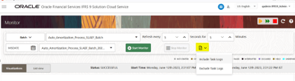

5.8.2 Generate the PDF
Perform the following steps to generate the PDF:
  1. Navigate to Operations and Processes, select Scheduler, and then select Monitor Batch.
  2. Select Batch and Run Id.
  3. Click Start Monitor.
  4. Click List View tab
  5. Click Generate PDF - Include Task Logs.
  6. Click Generate PDF - Exclude Task Logs.
    Figure 5-15 Generate the PDF
    Generate the PDF
