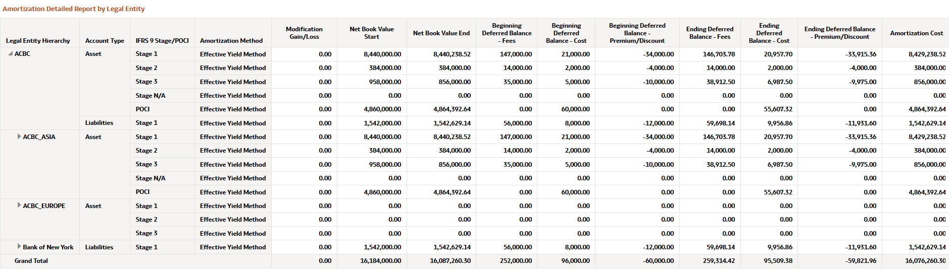

This is the first canvas under Amortization Reports. The pinned filters are enough to generate the report. The legal entity is a hierarchy-based dimension so this report will provide amortization measures at the legal entity hierarchy levels.
These reports can be viewed as Standalone or Consolidated reports.
To generate the below reports following dimensions are used: As of date, Modelling Set, ECL and Amortization Process, Consolidation Type, Legal Entity Node, and Reporting Currency Name.
The following set of reports are generated with the flag as Standalone.
Figure 7-71 Amortization Detailed Report by Legal Entity
Amortization Detailed Report by Legal Entity Report

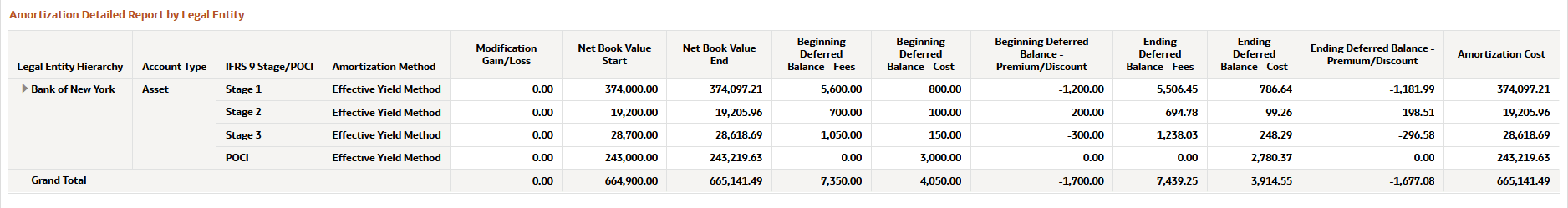

The following set of reports are generated with the flag as Consolidated.
Figure 7-72 Amortization Detailed Report by Legal Entity Report
