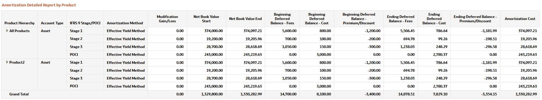

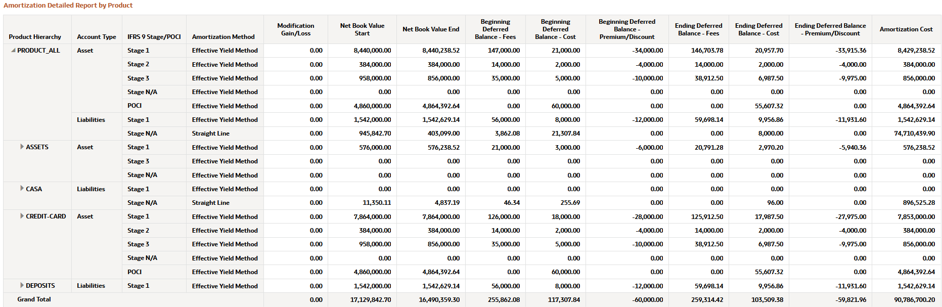

7.5.4 Amortization Detailed Report by Product
This is the fourth canvas under Amortization Reports. The pinned filters and dimension-based filter Product Leaf is required to generate this report. The Product is a hierarchy-based dimension so this report will provide amortization measures at product hierarchy levels.
These reports can be viewed as Solo or Consolidated reports.
To generate the below reports following dimensions are used: As of date, Modelling Set, ECL and Amortization Process, Standalone, Consolidated, Legal Entity Node, and Product Node and Reporting Currency Name.
Figure 7-75 Amortization Detailed Report by Product Report
Figure 7-76 Amortization Detailed Report by Product Report
