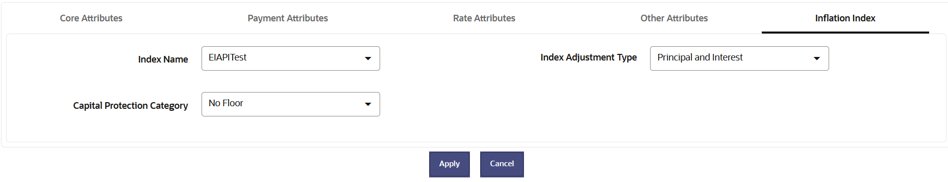

Figure 2-12 Inflation Adjustment Attributes tab to define the Product Characteristic Rule
Table 2-6 Fields to add the Index Adjustment attributes for New Businesses and their Descriptions
Field Behavior
Index Name Lists all Economic Indicators defined through the user interface.
Index Adjustment Type
Determines the type of Index Adjustment. Available options are:
Principal and Interest
Principal Only
Interest Only
Capital Protection Category
Determines capital protection to be provided to Inflation Indexed Instruments. Available options are:
No Floor: Does not provide any downside protection.
Floor of 1: Protects the downside movement.
Max during Life: Gives maximum advantage using maximum Index factor for calculation.
