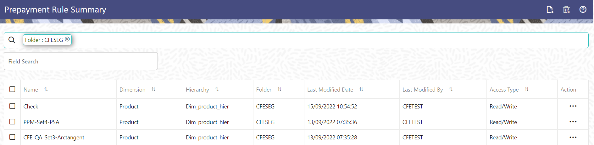

Prepayment Rule Summary
Prepayment Rules allow you to specify methodologies to model the loan prepayment and deposit, early redemption behavior of products in your portfolio, and quantify the associated prepayment risk in monetary terms.
Figure 2-1 Prepayment Rule Summary
The Prepayment Rule Summary displays the following information:
Add: Click the Add icon on the page header to build a new prepayment rule.
Multiple Delete: Enables you to select and delete one or multiple rules in the table simultaneously.
- Name: The Prepayment Rule's short name.
- Dimension: The Dimension to which the Prepayment Rule belongs.
- Hierarchy: Name of the hierarchy that is used to define the prepayment rule.
- Folder: The folder where the prepayment rule is saved.
- Last Modified By: The user who last modified the prepayment rule.
- Last Modified Date: The Date and Time when the prepayment rule was last modified.
- Access Type: The access type of the rule. It can be Read-Only or Read/Write.
- Action: Click this icon to view a list of
actions that you can perform on the prepayment rule.
- View/Edit: Based on the user privilege assigned, you can either only view or edit existing prepayment rules. To edit a rule, you must have Read/Write privilege.
- Save As: You can reuse a prepayment rule by saving it under a new name thus saving time and effort in entering data multiple times; it also leads to reduced data entry errors.
- Delete: You can delete prepayment rules that you no longer require. Note that only prepayment rule owners and those with Read/Write privileges can delete prepayment rules. A Prepayment Rule that has a dependency cannot be deleted. A rule cannot be retrieved after deletion.
- Dependency Check: You can perform a dependency check to know where a particular prepayment rule has been used. Before deleting a rule, it is always a good practice to do a dependency check to ensure you are not deleting prepayment rules that have dependencies. A report of all rules that utilize the selected prepayment rule is generated.
