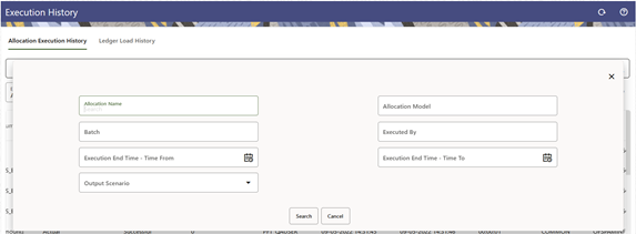

  1. Click the Search icon on the Search Pane to display the Criteria Window.
  2. Enter the Load Name, Batch, Load End Time, or Executed By and click Search to display the Allocation Rules that match the criteria.
  3. Click Cancel to remove the filter criteria on the Search Window and refresh the Window.
  4. Click Search after entering the Search Criteria.
    Figure 2-2 Ledger Load History – Criteria Window
    The screen displays the search results that meet the Search Criteria in a table containing all the Ledger Loads.
