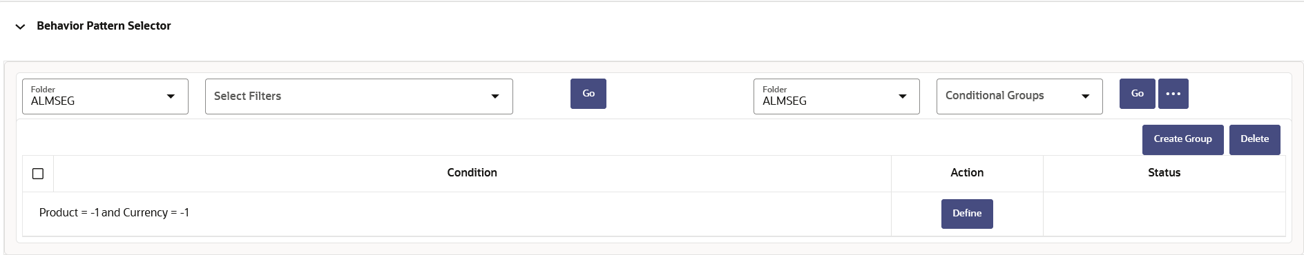

Figure 2-13 Conditional Assumption
- Select the Filter Folder and Filter, then click Go. The condition is displayed based on selected filter.
- Here, you can select either group of conditions using Conditional
Group or Individual condition using the filter section.

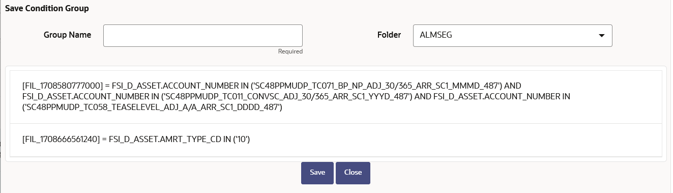

- The Save Condition Group window
is displayed. Provide the Group Name and
select the Folder where you want to save the
condition group. Click Save in
Save Condition Group window. You can use
this saved group from Condition Group
down-down.

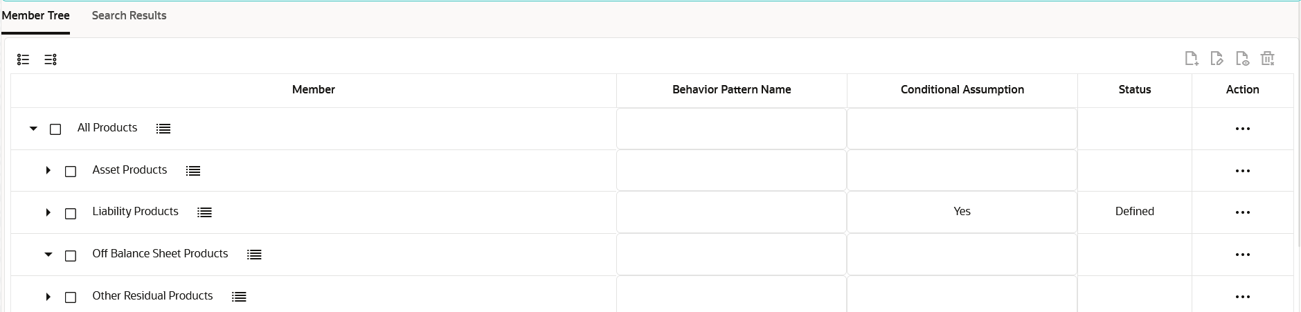

- Click Save. The status of conditional assumption
is also updated in Assumption Browser.
Figure 2-16 Status of Conditional Assumption
