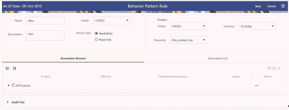

Figure 2-2 Behavior Pattern Rule Page

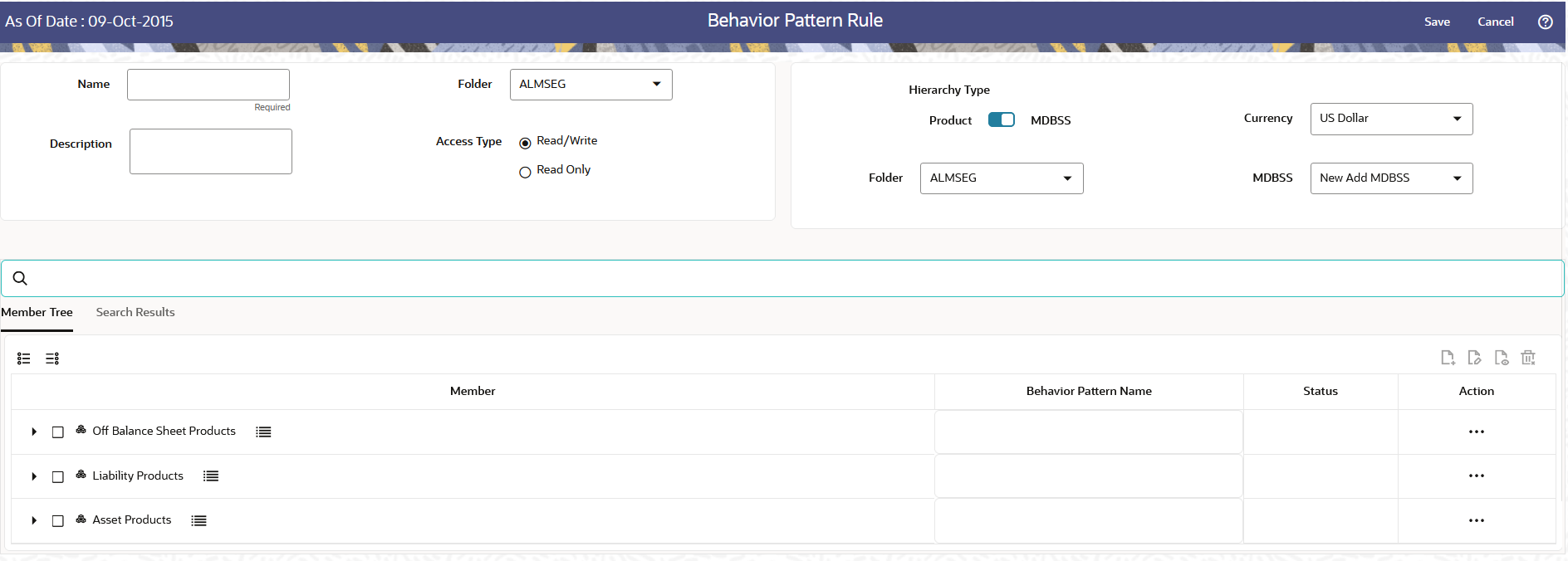

    • If you select Hierarchy Type as MDBSS, then following options are available:
      Figure 2-3 Hierarchy Type as MDBSS
      1. Select a Currency.
      2. Select a MDBSS Folder and MDBSS.
      3. SelectMDBSS Node(s) from Member Tree of Assumption Browser. The Assumption Browser has following two tabs: Member Tree and Search Results
        • Member Tree: Member Tree tab shows the hierarchical structure and allows you to define rules by selecting the node members from the browser. Select Node and Click Menu icon next to it to view the available options.
          Figure 2-4 Member Tree
          Member Tree

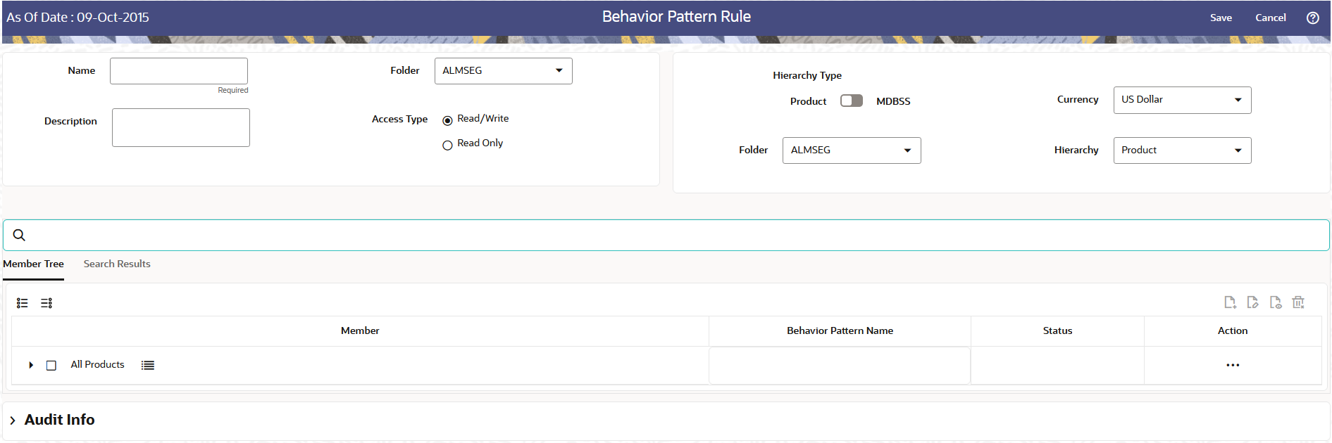

    • If you select Hierarchy Type as Product, then following options are available:
      Figure 2-7 Hierarchy Type as Product
      2. Select a Product Folder and Product Hierarchy.
      3. Select Product from Member Tree of Assumption Browser. The Assumption Browser has following two tabs: Member Tree and Search Results
          Figure 2-8 Member Tree
          Member Tree
