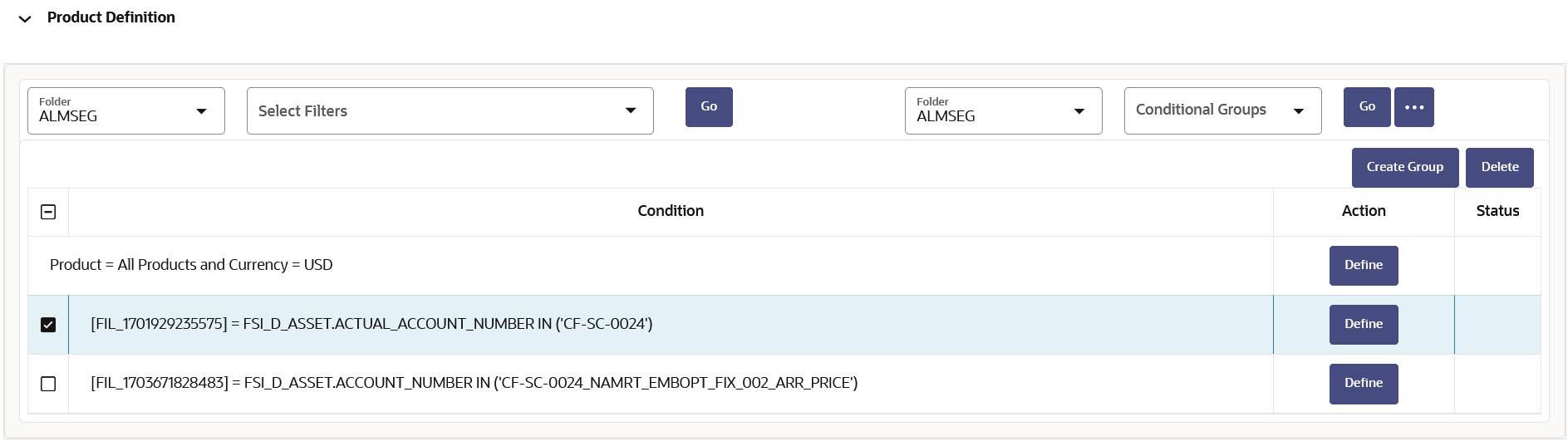

Figure 2-11 Conditional Assumption
- Select the Filter Folder and Filter, then click Go. The condition is displayed based on selected filter.
- Here, you can select either group of conditions using Conditional
Group or Individual condition using the filter section.
- You can select the conditional groups from the Conditional
Group drop-down. You can create a new condition group using
the Create Group button. To create a new condition
group, follow these steps:
- Select filters using the Filter drop-down
list.
You must select more than 2 filters to define a condition group. - Select the conditions (filters) using the corresponding check-boxes.
- Click Create Group .
- The Save Condition Group window is displayed. Provide the Group Name and select the Folder where you want to save the condition group. Click Save in Save Condition Group window. You can use this saved group from Condition Group down-down.

- Click Define.

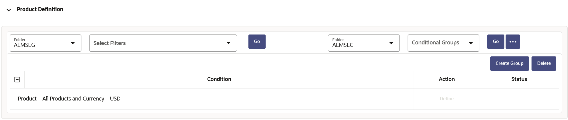

Figure 2-12 Conditional Assumption
Use Delete button to delete the defined condition(s)
- Define Discount Method, and then click Apply. The
status of condition assumption is updated as Defined.

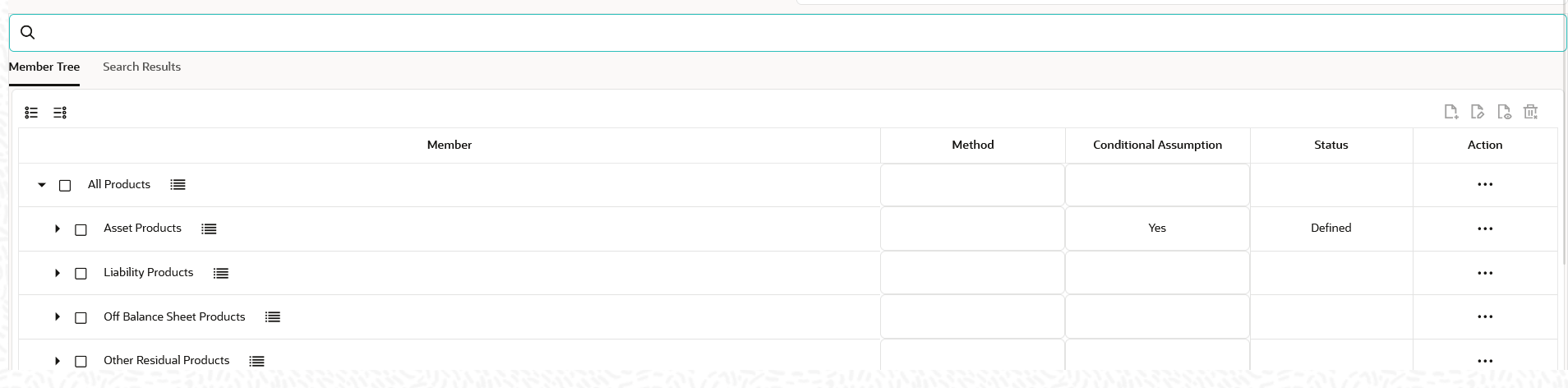

You can edit the condition using Edit. - Click Save. The status of conditional assumption is also
updated in Assumption Browser.
Figure 2-13 Status of Conditional Assumption
