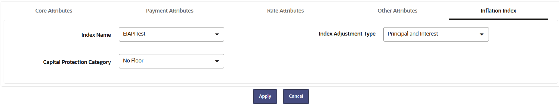

To enable the Define Inflation Adjustment Attributes secondary tab, select the Adjustment Type as Conventional Adjust, Conventional Fixed, Level principal, or Non-Amortizing.
Figure 2-12 Inflation Adjustment Attributes tab to define the Product Characteristic Rule
Table 2-6 Fields to add the Index Adjustment attributes for New Businesses and their Descriptions
| Field | Behavior |
| Index Name | Lists all Economic Indicators defined through the user interface. |
| Index Adjustment Type | Determines the type of Index Adjustment. Available options are: Principal and Interest Principal Only Interest Only |
| Capital Protection Category | Determines capital protection to be provided to Inflation Indexed Instruments. Available options are: No Floor: Does not provide any downside protection. Floor of 1: Protects the downside movement. Max during Life: Gives maximum advantage using maximum Index factor for calculation. |
