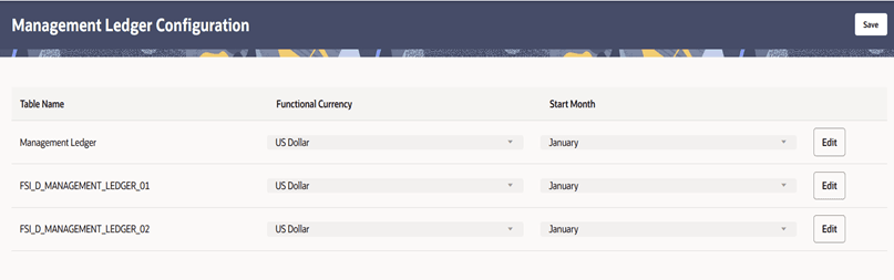

    Figure 1-1 Management Ledger Configuration
    The Management Ledger Configuration screen allows you to input the Management Ledger Configuration for Profitability Management Cloud Service.
