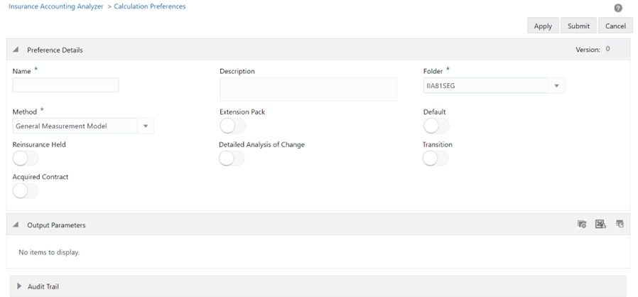

  1. In the Calculation Preference window, click Add to open the Calculation Preferences window.
    Figure 3-10 The Calculation Preferences Window
    The Calculation Preferences window
  2. Click the Extension Pack slider to use the new Output Variables that were created on the Extension Pack Template page. When this feature is enabled, the Detailed Analysis of Change, Transition, Acquired Contract, and Disaggregate Insurance Finance Expense sliders are disabled.
    Figure 3-11 The Calculation Preferences Window with the Extension Pack slider enabled

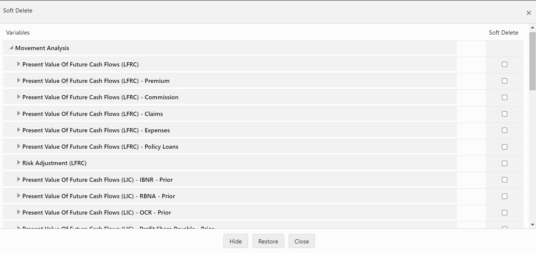

  4. The Soft Delete icon in the Output Parameters pane, enables you to delete a variable:
    1. Click the Soft Delete icon to open the Soft Delete window.
      Figure 3-12 Soft Delete Window
      Soft Delete window
    2. In this window, select the variables that you want to hide and then click the Hide button.
      The selected variables are hidden from the list.
    3. To restore the list of variables to its default state, in the Soft Delete window, click the Restore button.
      The variables that were previously hidden will appear in the list of variables.

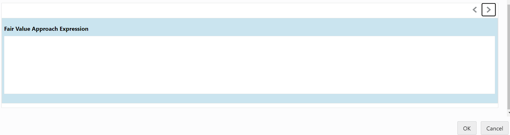

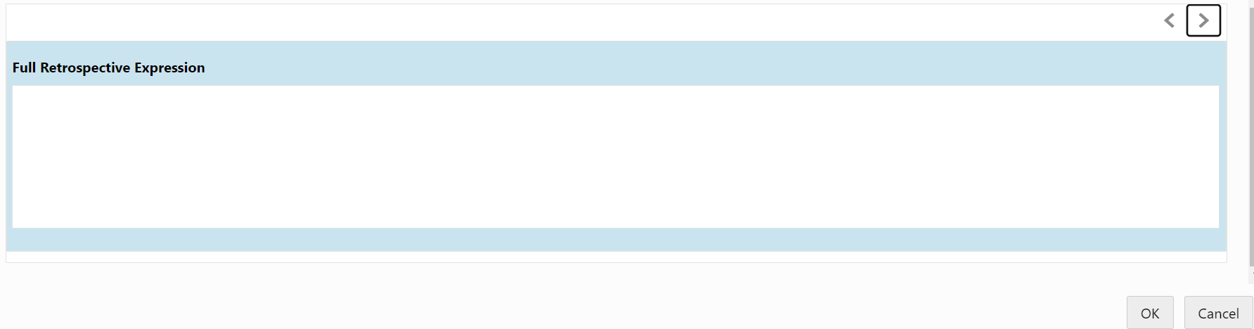

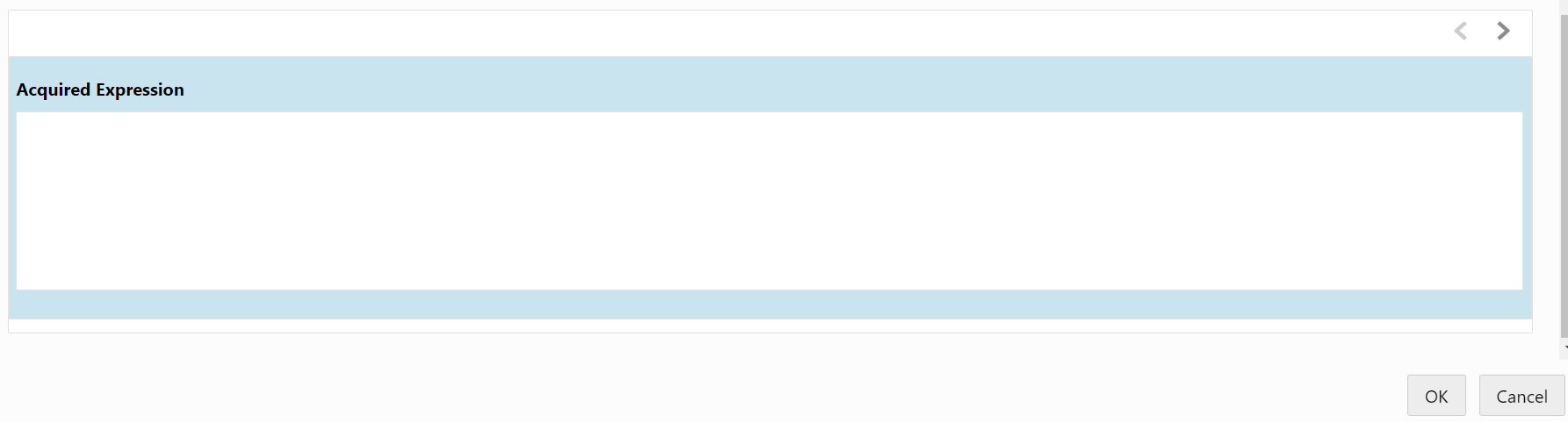

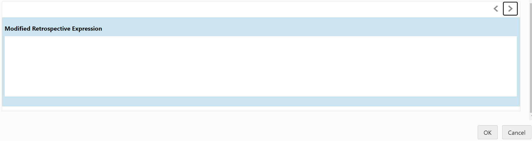

  5. For each approach, you can give an Expression in a single Template starting with the Non Transition Expression box at the top. Click the Acquired Expression field at the bottom expression builder box and then select the required Input Parameters from the list to populate the Acquired field pane. The other fields Fair Value Approach Expression, Full Retrospective Expression, Modified Retrospective Expression and Acquired Full Retrospective Expression can be seen by clicking on the right arrow at the top corner of the bottom expression builder box. Separate expressions can be built for each of these using the input variables, output variables, macros and functions.
    Figure 3-13 The Acquired Expression field in the Calculation Configuration Window
    Figure 3-14 The Fair Value Approach Expression field in the Calculation Configuration Window
    Figure 3-15 The Full Retrospective Expression field in the Calculation Configuration Window
    Figure 3-16 The Modified Retrospective Expression field in the Calculation Configuration Window
