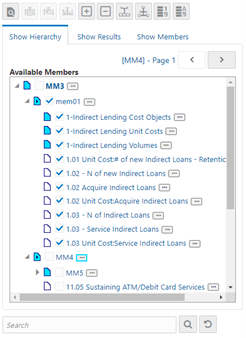

Figure 7-5 Show Hierarchy Tab
The Show Hierarchy tab displays the leaves in each node in ascending order of Members.

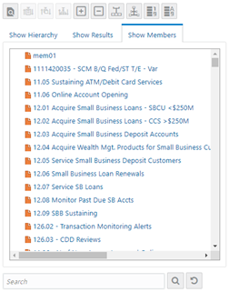

Figure 7-6 Show Members Tab
The Show Members tab displays all the selected nodes in a list view, which helps you visualize all the selected nodes as a list rather than as a tree. Currently, this feature is available in the Edit and View mode of the Hierarchy Filter.
