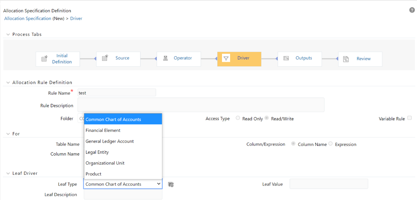

For the Leaf, Field, and Dynamic Driver allocation types, a For pane is displayed in which you can choose either a driver table and column or an Expression to serve as the source of your Driver data.
  • Leaf Driver Pane: The Leaf Driver pane is only displayed for the Leaf allocation type. Use this pane to specify the dimension and leaf value you wish to use.
Figure 15-19 Driver Process tab - Leaf Driver Pane
