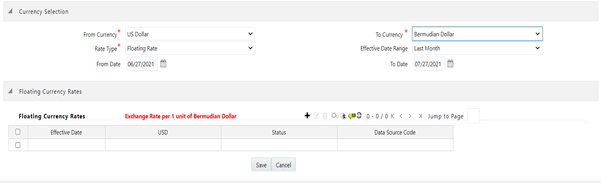

To view, edit, or delete the exchange rate data, you must enter the To Currency value. With the From Currency, the To Currency drop-down list displays only Active currencies.
Figure 10-10 Currency Rates Summary page
The Currency Rates Summary page allows you to define the exchange rate data for the To Currency values.
After selecting a To Currency value, select a value for Rate Type as Floating Rate or Fixed Rate (the default selection is Floating Rate). After selecting a To Currency value, a second pane is displayed as Floating Currency Rates (if you have chosen a Rate Type of Floating Rate) or Fixed Currency Rates (if you have chosen a Rate Type of Fixed Rate).
