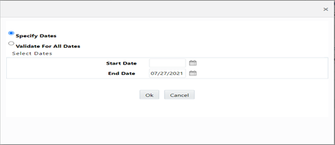

Execute the exchange rate validation using the Currency Rates Validation option.
Figure 10-13 Currency Rate Validation window
The Currency Rate Validation window allows you to execute and exchange rate validation suing the currency rate validation option.
To execute the exchange rate validation, follow these steps:
  1. Select a check box on the left-hand side of any row to enable the Currency Rates Validation icon.
  2. Click Currency Rates Validation.
  3. To execute exchange rate validation from the Currency Rates window, the following two options are available:
    • Specify Dates: After selecting this option, a Select Dates pane is displayed to enter or verify the FROM_DATE and TO_DATE parameters. These dates will be passed to the batch for execution.
    • FROM_DATE: This defaults to the date of last rate validation.
    • TO_DATE: This defaults to the current date.
    • Validate For All Dates: Select this option to validate all the rates irrespective of dates.
    This option will replace all of the validated exchange rate history and can be a time-consuming process depending on the amount of history available to be processed.
