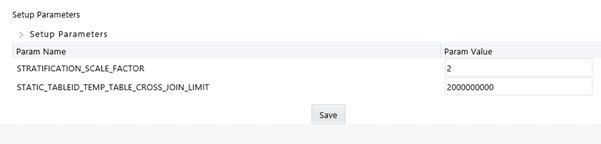

14.3 Setup Parameters
To configure setup parameters, follow these steps:
- From the LHS menu, select Insurance Allocation Manager,
select Configuration, and then select Setup
Parameters.
Figure 14-3 Setup Parameters
- Enter the following details:
- STRATIFICATION_SCALE_FACTOR: This parameter is not used by the PFT application.
- STATIC_TABLEID_TEMP_TABLE_CROSS_JOIN_LIMIT: Integers between 0 and 99. The default value is 20 million. If the Cartesian product of the leaf values selected for each dimension exceeds this limit, then the static table driver UI displays only the already defined combinations. Further reducing this parameter value improves the UI performance, since UI only displays the already existing definitions.
- Click Save.
