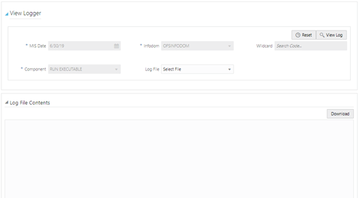

- On the Subledger Definition Summary page, in
the Run Status column, select the status link corresponding to the
sub-ledger definition that you want to view the error log for. The
View Logger window appears.
Figure 4-49 The View Logger Window
- Click the Log File drop-down list to select a log file.
- Click View Log to populate the Log File Components pane.
- Additionally, you can click Download if you want to download the selected log file.
- Click Close to go back to the Subledger Definition window.
