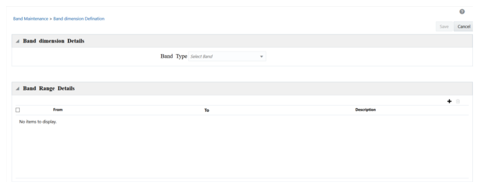

Create a New Band Definition
Perform the following steps to create a new Band definition, perform following steps:
- From the Band Type table, click
Add, to open the Band Dimension
Definition window.
Figure 12-2 The Band Dimension Definition Window
- Click the drop-down list adjacent to the Band Type field and select a Band Type from the available list.
- Enter the Band Range by clicking Add in the Band Range Details table.
- Enter the From and To values for all the band ranges. You
can optionally enter descriptions for all the ranges.
You can also select the checkbox adjacent to a Band Range and click Delete to remove an existing Band Range.
- Click Save to save the definition.
The saved definition is displayed in the BandMaintenance table of the BandMaintenance Window.
The Audit Trail pane at the bottom of the definition window displays the Created By, Creation Date, last modified by, and Last modification date details. The User Comments field enables you to add additional information as a comment.
