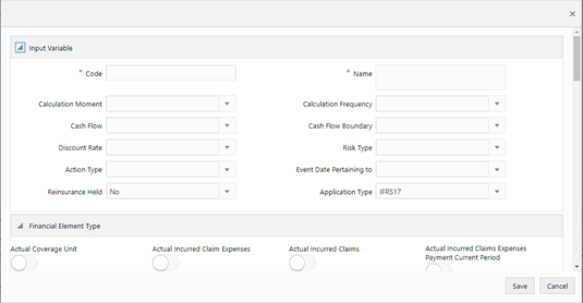

  1. In the Variables table, click Add to open the New Variable window.
    Figure 4-31 The New Variable Window
  2. Populate the Input Variable form.
    Table 4-6 The Input Variable pane
    Field Description

  3. Under the Financial Element Type pane, click the icon to enable the required cash flow types. For more information on the available financial element types, see List of Financial Element Types.
  4. Click Save.
    The saved definition is displayed in the Variables table on the Variable Maintenance window.
