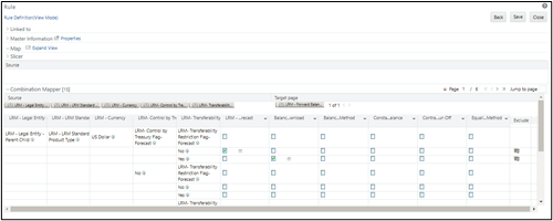

In the Run Definition window, Include Forward Date Calculations is selected as Yes and the Forward Balance Method Mapping Rule is selected as LRM – Balance Method Reclassification.
The Out of Box Rule name is “LRM - Balance Method Reclassification – Forecast”.
The Out of Box rule has sample mappings and it is expected to change the mapping as per the requirement
The list of mandatory source dimensions for this rule is follows:
- Standard Product Type
- Legal Entity
- Currency
- Transferability Restriction
- Control By Treasury Flag
These are mapped to the target dimension “Forward Balance Method Type”. For Balance
Calculation, following methods are available from the Liquidity Risk Management > Manage
LRM Rules > Rule > Run Definition window:
- Contractual Run Off
- Equally Changing Balance
- Balance Download
- Balance Change Download
- Constant Balance
- Cash Flow Download Method
Figure 5-2 Balance calculation method
