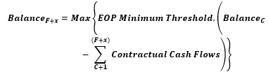

- The application calculates the forward balance as of the first
forward date as follows:
Where,
F : First forward date
C : Current date i.e. As of Date selected in the Run Management window
EOP Minimum Threshold : Floor for the account balance i.e. the minimum balance to be maintained at all times
- The application calculates the forward balance for each subsequent
Where,
F + x : Each subsequent forward date
x : Interval between each forward date

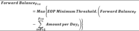

- The balance for each dimensional combination on each
forward date is calculated as follows:
Where,
F : Previous forward balance. The balance as of the first forward date is provided as a download.
t : Time period between previous forward date (exclusive) to next forward date (inclusive)
