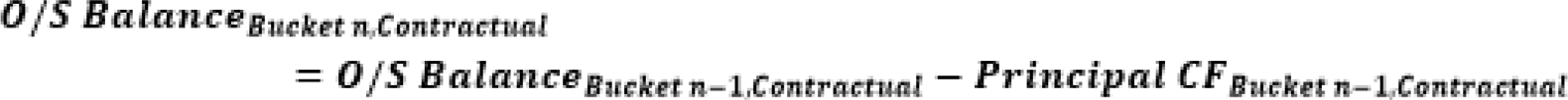

  3. Calculate the outstanding balance in each bucket under contractual terms. The outstanding balance in the first time bucket will be the EOP balance. The formula for calculating the outstanding balance for each subsequent bucket is as follows:
    Figure 12-1 Formula for calculating outstanding balance
    This illustration shows the formula for calculating the outstanding balance for each subsequent bucket.
    Where,
    O/S Balance: Outstanding Balance CF:
    Cash Flows

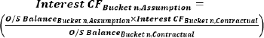

  6. Calculate the impact on interest cash flows in each bucket under business-as-usual or stress terms as per the following formulas:
    Figure 12-3 Formula to calculate the impact on interest cash flows
    This illustration shows the formula to calculate the impact on interest cash flows in each bucket under business-as-usual or stress terms.
    This illustration shows the formula to calculate the impact on interest cash flows in each bucket under business-as-usual or stress terms. image328
