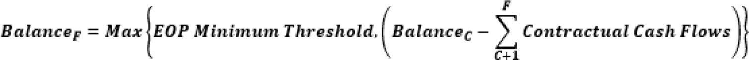

    The steps involved in calculating balances at a forward date under contractual terms when the method is selected as “contractual run off” are as follows:
    1. The un-bucketed contractual cash flows based on the current date are obtained as a download. The current date is equal to the As of Date selected during Run Execution.
    2. The current balance of each account as of the “As of Date” is received. This is the starting balance for forward date calculations.
      Figure 16-3 Formula for calculating the forward balance as of the first forward date
      This illustration shows the formula for calculating the forward balance as of the first forward date.
    3. The application calculates the forward balance as of the first forward date as follows:
      Where,
      F: First forward date
      EOP Minimum Threshold: Floor for the account balance that is the minimum balance to be maintained at all times

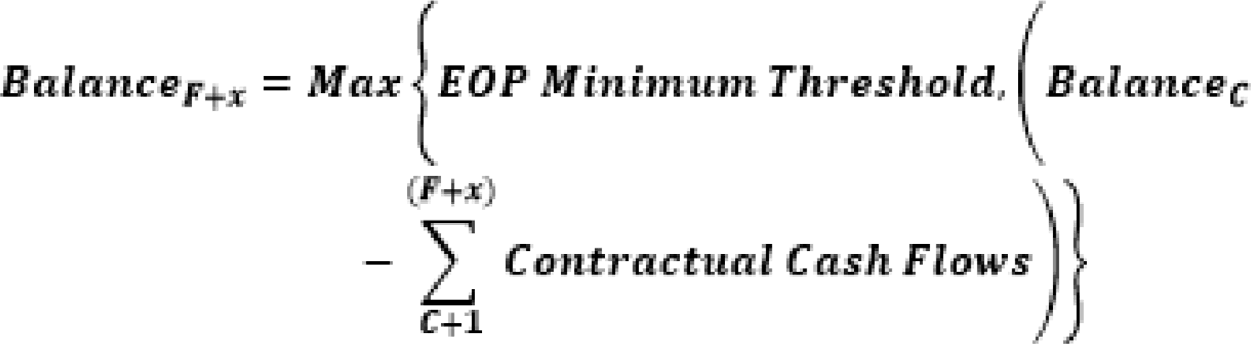

    4. The application calculates the forward balance for each subsequent forward date as follows:
      Figure 16-4 Formula for calculating the forward balance for each subsequent forward date
      This illustration shows the formula for calculating the forward balance for each subsequent forward date.
      Where,
      F + x: Each subsequent forward date x
      : Interval between each forward date
      • If an EOP minimum threshold is specified, the contractual cash flows are run-off only till the minimum threshold is reached. Any contractual cash flows which result in the forward balance dropping below the minimum threshold will not be a run-off. Once the minimum threshold is reached, it is maintained as the constant balance for all subsequent forward dates for that Run and dimensional combination.
      • For example, the forward balance as of 31st December is 5200 the minimum threshold is 5000 and contractual cash outflow between 31st December and the next forward date which is 31s January is 500. In this case, the balance as of 31st January is 500 that is (minimum of 5000,
        5200-500).
      • If no minimum threshold is specified, then the application runs off the contractual cash flows till balance equals zero.

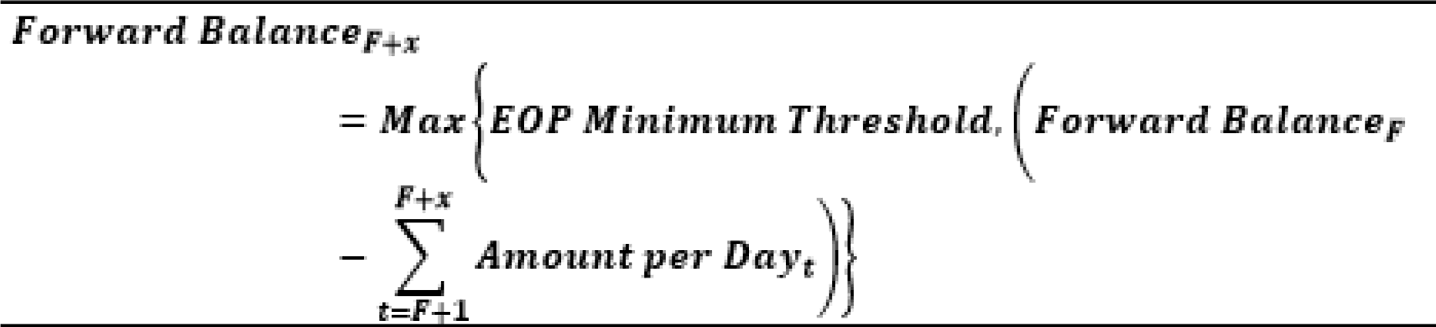

        The equally changing amount computed here is the forward cash flow as of each calendar or business day depending on whether holidays are included or excluded. If holidays are excluded for calculating the equally changing amount, the cash flows on such excluded days are 0.
    3. The balance for each dimensional combination on each forward date is calculated as follows:
      Figure 16-7 Formula to calculate the balance for each dimensional combination on each forward date
      This illustration shows the formula to calculate the balance for each dimensional combination on each forward date.
      Where,
      F: Previous forward balance. The balance as of the first forward date is provided as a download. X: Interval between each forward date
      T: Time period between previous forward date (exclusive) to next forward date (inclusive)
      The equally changing balance method and inputs required for this method are illustrated in the following table. All values are in terms of US Dollars.

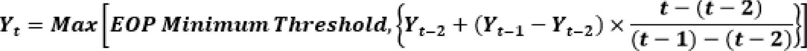

    The steps involved in calculating balances at a forward date under contractual terms when the method is selected as “balance download” are as follows:
    1. The forward balances for multiple forward dates are received as a download across dimensional combinations.
    2. The application computes the forward balance for missing forward dates as follows:
      1. If forward balance is not available for each forward date
        The missing forward balance is interpolated using the balances available on the dates immediately prior and immediately following the missing forward date as follows:
        Figure 16-8 Formula to calculate the forward balance for missing forward dates
        This illustration shows the formula to calculate the forward balance for missing forward dates.
        Where,
        Yt: Missing forward balance
        Yt-1: Known balance on forward date immediately preceding the missing forward date Yt+1:
        Balance on forward date immediately succeeding the missing forward date
        t: Cumulative time, in days, from first forward date to each subsequent forward date. The cumulative time is based on business days if holidays are to be excluded and based on calendar days if holidays are to be included.
        An example of interpolation when frequency of forward dates is a week and holidays are included is as follows:

      2. If a forward balance is not available on the last forward date
        The missing forward balance is extrapolated using the forward balances available on the two dates immediately before the missing forward date as follows:
        Figure 16-9 Formula to calculate the forward balance for missing forward dates
        Where,
        Yt: Missing observation that is value of the forward balance to be forecasted at time ‘t’ Yt-1: Known value of observation at time‘t-1’
        Yt-2: Known value of observation at time‘t-2’
        t: Cumulative time, in days, from the start date of the first observation period to the end of each observation period .
        An example of extrapolation when the frequency of forward dates is a month and holidays are included is as follows:
        Table 16-11 Illustration - Extrapolation when Frequency of Forward Dates Week is a month and Holidays Included
        Input Calculation
        Forward Date Forward Balance Download Value Period Start Period End Cumulative Calendar Days Missing Forward Balance
        31-Jan-14 742 31-Jan-14 31-Jan-14 1
        28-Feb-14 438 01-Feb-14 28-Feb-14 29
        31-Mar-14 724 01-Mar-14 31-Mar-14 60
        30-Apr-14 603 01-Apr-14 30-Apr-14 90
        31-May-14 859 01-May-14 31-May-14 121
        30-Jun-14 426 01-Jun-14 30-Jun-14 151
        31-Jul-14 268 01-Jul-14 31-Jul-14 182
        31-Aug-14 379 01-Aug-14 31-Aug-14 213
        30-Sep-14   01-Sep-14 30-Sep-14 243 486
        31-Oct-14   01-Oct-14 31-Oct-14 274 597
        30-Nov-14   01-Nov-14 30-Nov-14 304 705
        31-Dec-14   01-Dec-14 31-Dec-14 335 816
        An example of extrapolation when the frequency of forward dates is a month and holidays are excluded is as follows:
        Table 16-12 Illustration - Extrapolation when Frequency of Forward Dates Week is a month and Holidays excluded
        Input Calculation
        Forward Date Forward Balance Download Value Period Start Period End Cumulative Business Days Missing Forward Balance
        28-Feb-14 438 01-Feb-14 28-Feb-14 21
        31-Mar-14 724 01-Mar-14 31-Mar-14 42
        30-Apr-14 603 01-Apr-14 30-Apr-14 64
        31-May-14 859 01-May-14 31-May-14 86
        30-Jun-14 426 01-Jun-14 30-Jun-14 107
        31-Jul-14 268 01-Jul-14 31-Jul-14 130
        31-Aug-14 379 01-Aug-14 31-Aug-14 151
        30-Sep-14   01-Sep-14 30-Sep-14 173 495
        31-Oct-14   01-Oct-14 31-Oct-14 196 617
        30-Nov-14   01-Nov-14 30-Nov-14 216 723
        31-Dec-14   01-Dec-14 31-Dec-14 239 844

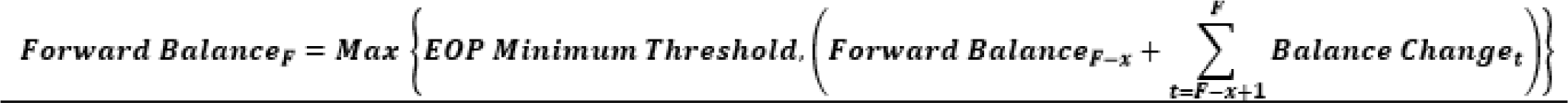

  4. Balance Change Download:
    The steps involved in calculating balances at a forward date under contractual terms when the method is selected as “balance change download” are as follows:
    1. The balance change for multiple forward dates is received as a download across dimensional combinations. A positive value indicates an increase in balance while a negative value indicates reduction.
    2. The spot balances are identified for the same dimensional combination as the balance change download.
    3. The application calculates the forward balance as of each day as follows:
      Figure 16-10 Formula to calculate the forward balance as of each day
      This illustration shows the formula to calculate the forward balance as of each day.
      Where,
      F : Each forward date for which balance is calculated
      F – x : Previous forward date for which calculations are done X : Interval between each forward date
      T : Time period between previous forward date (exclusive) to next forward date (inclusive)
      • If no balance change is specified for the time period between the previous forward date to next forward date, then the balance calculated as of the previous forward date is assumed to continue “as-is”.
      • If no balance change is specified for the first forward date, the spot balance is assumed to continue.
