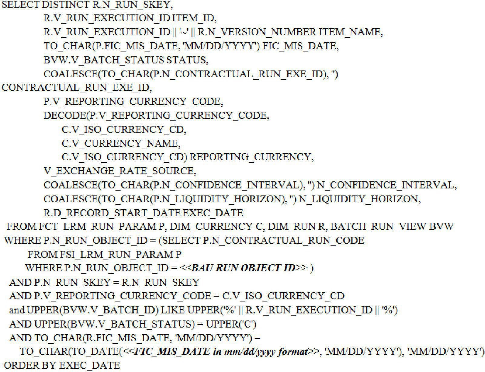

    6. CONTRAEXECID: For BAU, enter the ID of the Contractual Run execution to be used. The following query can be used to find the various Contractual Run Execution IDs:
      Choose any value of ITEM_ID column as an input for CONTRAEXECID from the result of the query.
      Figure B-1 CONTRAEXECID
