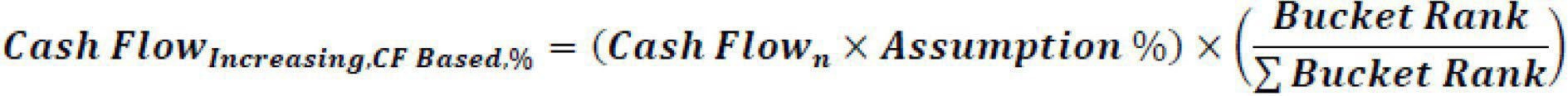

    1. When, Cash Flow Based Assumptions, Assumption Unit = Percentage
      Figure 7-48 Cash flow based authentication

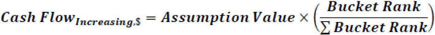

    2. When Assumption Unit = Value
      Figure 7-49 Cash flow increasing assumption

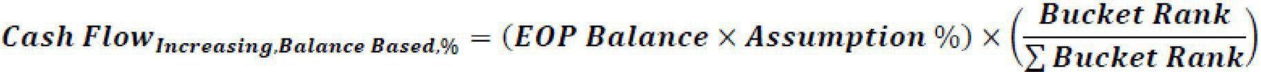

    3. When, EOP Balance Based Assumptions, Assumption Unit = Percentage
      Figure 7-50 Cash flow increasing balance
      The following example shows Increasing Cash Flow assignment method based on EOP Balance. Here, EOP Balance (Time Deposits) is assumed as 300000.

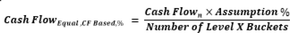

  3. Equal Assignment
    The Cash flows are to be assigned equally up to the selected bucket. Assignments are made equally to the selected level and further assignment is done until the most granular level.
    The formulae under different conditions are as follows:
      Figure 7-54 Formula for calculation of cash flows.
      This illustration shows the formula for calculation of cash flows.
