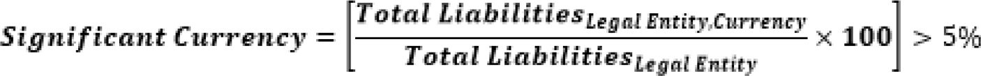

The liquidity coverage ratio is also calculated for each legal entity at the level of each significant currency to identify potential currency mismatches. This is done by first identifying significant currencies for a legal entity, at a solo or consolidated level as specified in the Run as follows:
Figure 14-36 Formula to calculate the Significant Currency LCR
This illustration shows the formula to calculate the Significant Currency LCR.
