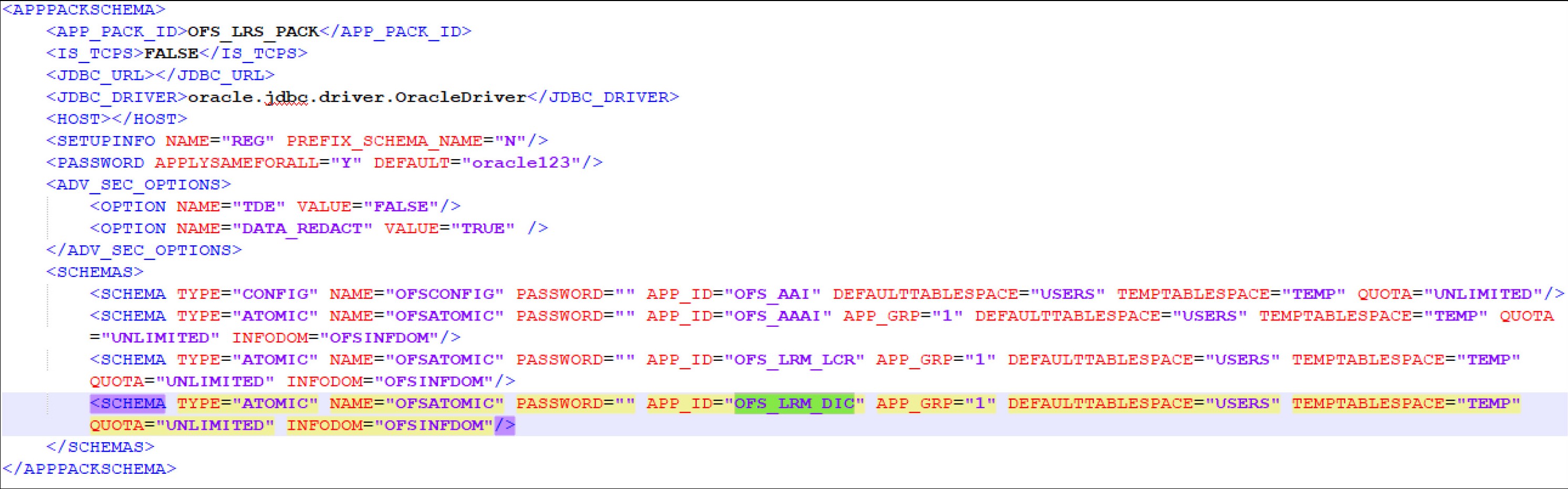

To configure the OFS_LRS_SCHEMA_IN.xml file, follow these steps:
  1. Log in to the system as a non-root user.
  2. Navigate to the OFS_LRS_PACK/schema_creator/conf directory.
  3. Edit the OFS_LRS_SCHEMA_IN.xml file using a text editor.
    Figure 7-2 Sample OFS_LRS_SCHEMA_IN.xml File
  4. Configure the values as mentioned in the following table and save the file.
    On successful execution of the utility, the passwords entered in the OFS_LRS_SCHEMA_IN.xml file are nullified.
