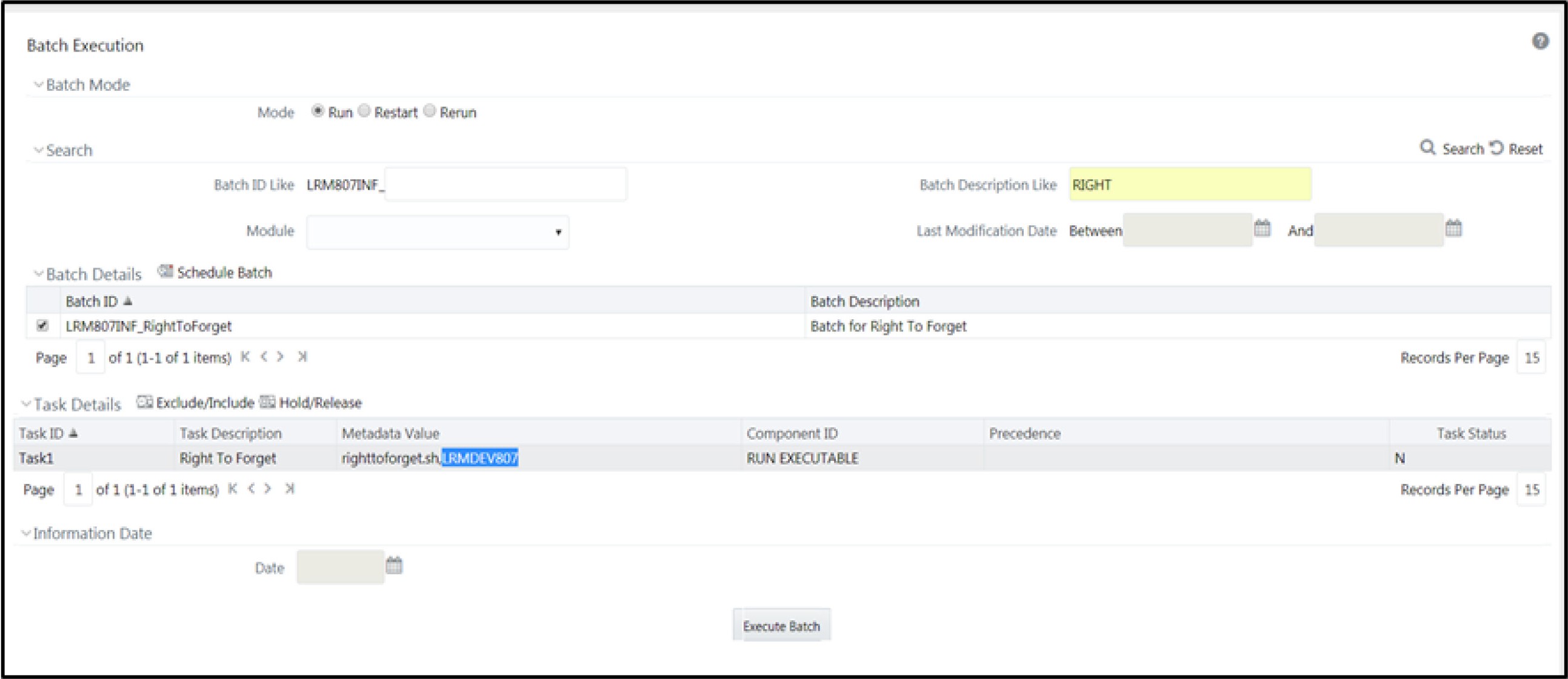

To configure Right to be Forgotten, follow these steps:
- Ensure that you assign the role Data Controller to the LRM user.
- Edit the task of the batch
<Infodom_name>_RightToForget
. By default, the parameter is SYSADMN. Modify the user ID in the Metadata Value field to the LRM Data Controller user ID from Step 1.Figure 8-7 Configure Right to be Forgotten for OFS LRS
- Add the party IDs entries for the Right to Forget in the
FSI_PARTY_RIGHT_TO_FORGET
table. - Execute the batch
, for the specific FIC MIS date mentioned in the FSI_PARTY_RIGHT_TO_FORGET table.
