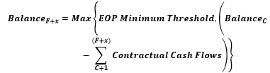

  4. The application calculates the forward balance for each subsequent forward date as follows:
    This image displays the Balance F+x.
    Where:
    F + x: Each subsequent forward date
    x: Interval between each forward date
    1. If a EOP minimum threshold is specified, the contractual cash flows are run-off only till the minimum threshold is reached. Any contractual cash flows which results in the forward balance dropping below the minimum threshold will not be run-off. Once the minimum threshold is reached, it is maintained as constant balance for all subsequent forward dates for that Run and dimensional combination. For instance the forward balance as of 31st December is 5200, minimum threshold is 5000 and contractual cash outflow between 31st December and the next forward date which is 31st January is 500. In this case, the balance as of 31st January is 5000 i.e. (minimum of 5000, 5200-500).
    2. If no minimum threshold is specified, then the application runs off the contractual cash flows till balance equals zero.
