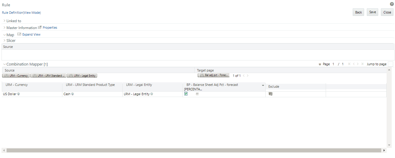

The Out of Box rule has sample mapping and values in the target. The Manual Adjustment percentage (the target BP, a parameterized BP) is an input as per the requirement.
The sum total of the Manual Adjustment percentage has to be 100%.
Figure 6-4 Manual Adjustment Rule
This image displays the Manual Adjustment Rule.
