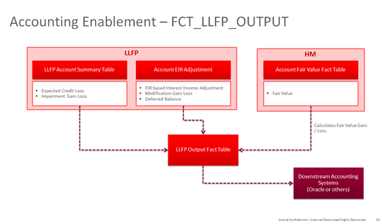

Figure 17-1 The Accounting Enablement - FCT_LLFP_OUTPUT Process Flow
This illustration shows the process flow of the Accounting Enablement - FCT_LLFP_OUTPU with the process being LLFP Account Summary Table, containing Expected Credit Loss and Impalment Gain Loss, Account EIR Adjustment, containing EIR based Interest Income Adjustment, Modification Gain Loss and Deferred Balance, and in HM Account Fair Value Fact Table, containing Fair Value, that move into the LLFP Output Fact Table. The LLFP Output Fact Table then moves in to the Downstream Accounting Systems (Oracle or others).
